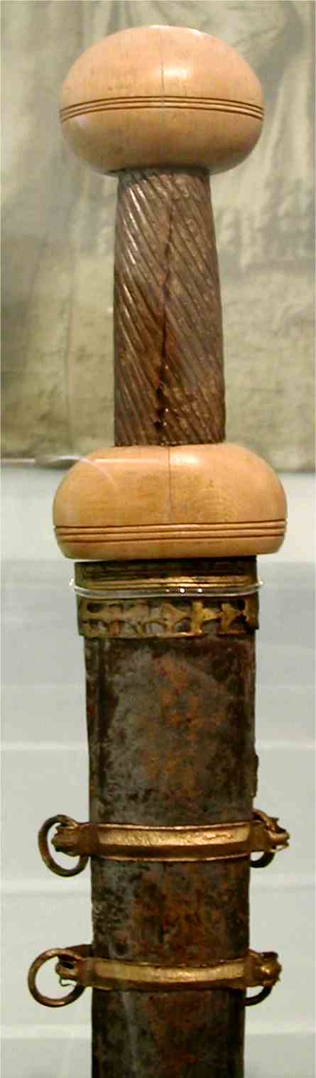

That pommel may be round but the bolster certainly isn't. Did they perhaps use the thumb on bolster to index ?

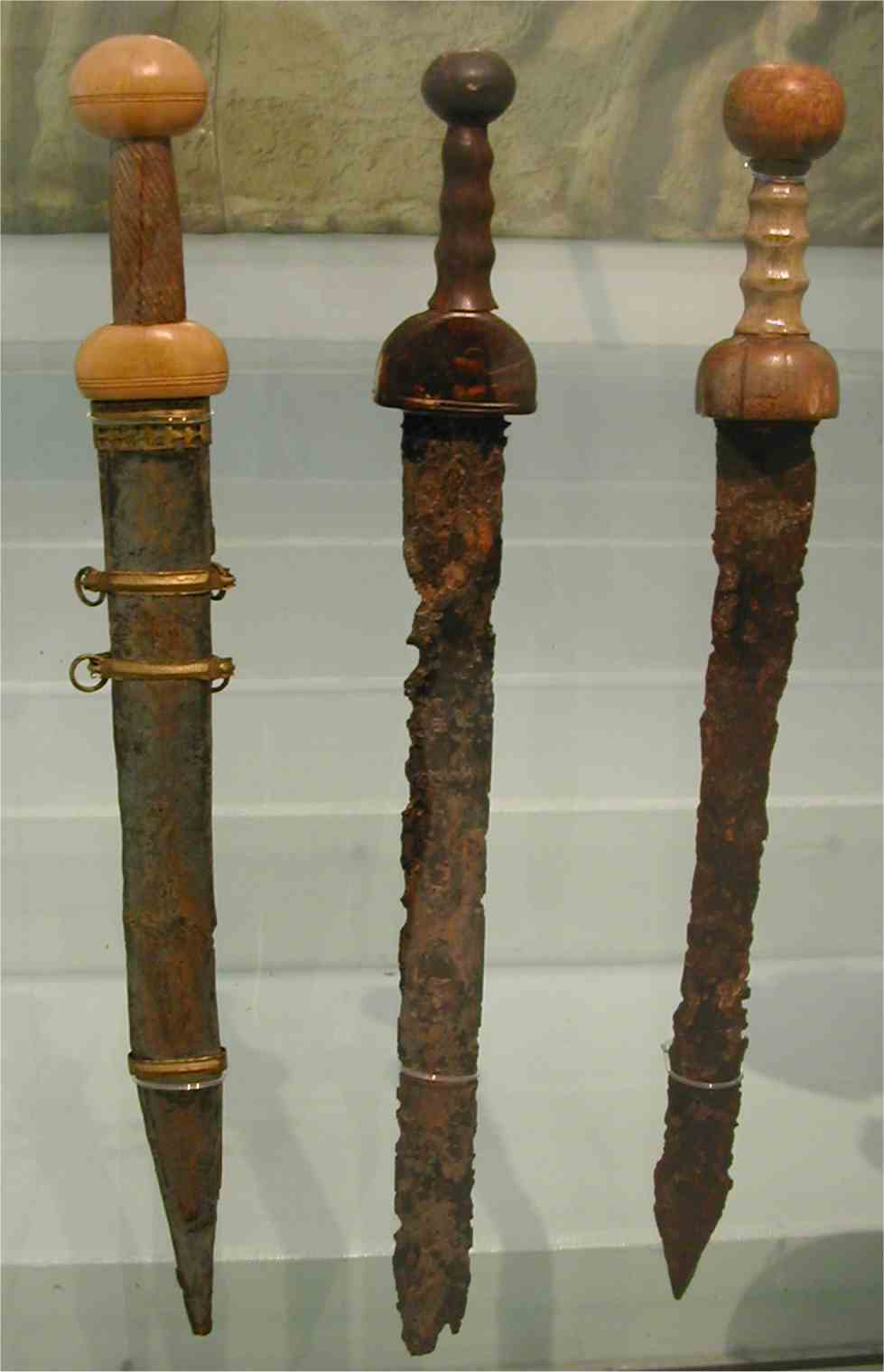

Many museum pieces of Roman gladii have full circular grips
Yeah, and look what happened to them. :p
I have a feeling the weight and air resistance would keep you on track for the most part. It would just feel wrong to swing a sword sideways no matted what the handle shape.
The Roman Gladius was a stabbing implement. Yes, it could cut as well as any short sword of the time, but the Roman infantry formations were tight and their shields were big. Writings from the period refer to it is a thrusting weapon over and over. Lack of an index for a swing is a pain, but the guard is oriented with the edge and probably provided good sense of where the edge was going.

Sure, a simple straight cylinder probably does suck for just about any sword but the gladius examples above are shown in profile only. We don't see all angles. We certainly can't comment on the custom you saw but offer only a general statement. If you made an assessment of the guy without bothering to discuss it with him, well, we'll never know.
What looks round in profile, often is not.

I'd also bet, most Gladius handles would have a bit of oblong. Many had squarish handles (or rectangle-ish).
That "round" handle above seems to have a bit of oval, thought it van be hard to tell with a two dimensional picture.

Great pics Horseclover.
It seems to my eye that some of those have oblong shape (like the two handed/bastard/great swords?)
The rounder looking handles seem to be more thrust oriented, or have a knuckle guard, which would help keep the sword oriented.
Seems like some daggers have more rounded handles.

Idk, my rapiers have round, albeit tapering, handles. Doesn't really seem to matter much. most of the swords Horseclover pictured are wrapped with wire, grooved, or have increased friction added in some other way,such as the ringlike protrusions under leather wrapping. I do think that a hilt too large for ones' hand is a downside, no matter what the style may be. I'm not sure a perfectly (or close to perfect) round hilt would be a real detriment, however. There are a lot of tools with round handles, and those are made to be used all day, such as rakes, hoes, and shovels. Most pikes and spears have round handles as well. I'm sure round is undesirable with some items that absolutely MUST be held properly to operate, such as a longbow, I'm just not sure a sword or knife, for that matter, would suffer much penalty from it.

Perhaps you'd like to expand on your comment of seeing a lot of swords made "that" way. A good number of swords in history have quite round ferrules and even the pommels on the other end. I spent less than ten minutes showing a variety of swords across history that have the very feature I mentioned, while most of those are not truly round in cross section for the bulk of the grip. You made another rather sweeping comment on Roman gladius, perhaps not knowing swords in history both predating that and some to this day have similar characteristics. From what you have shared in comment so far, one _could_ assume you know little about swords but I do agree, a simple cylinder does suck on many sword types.
