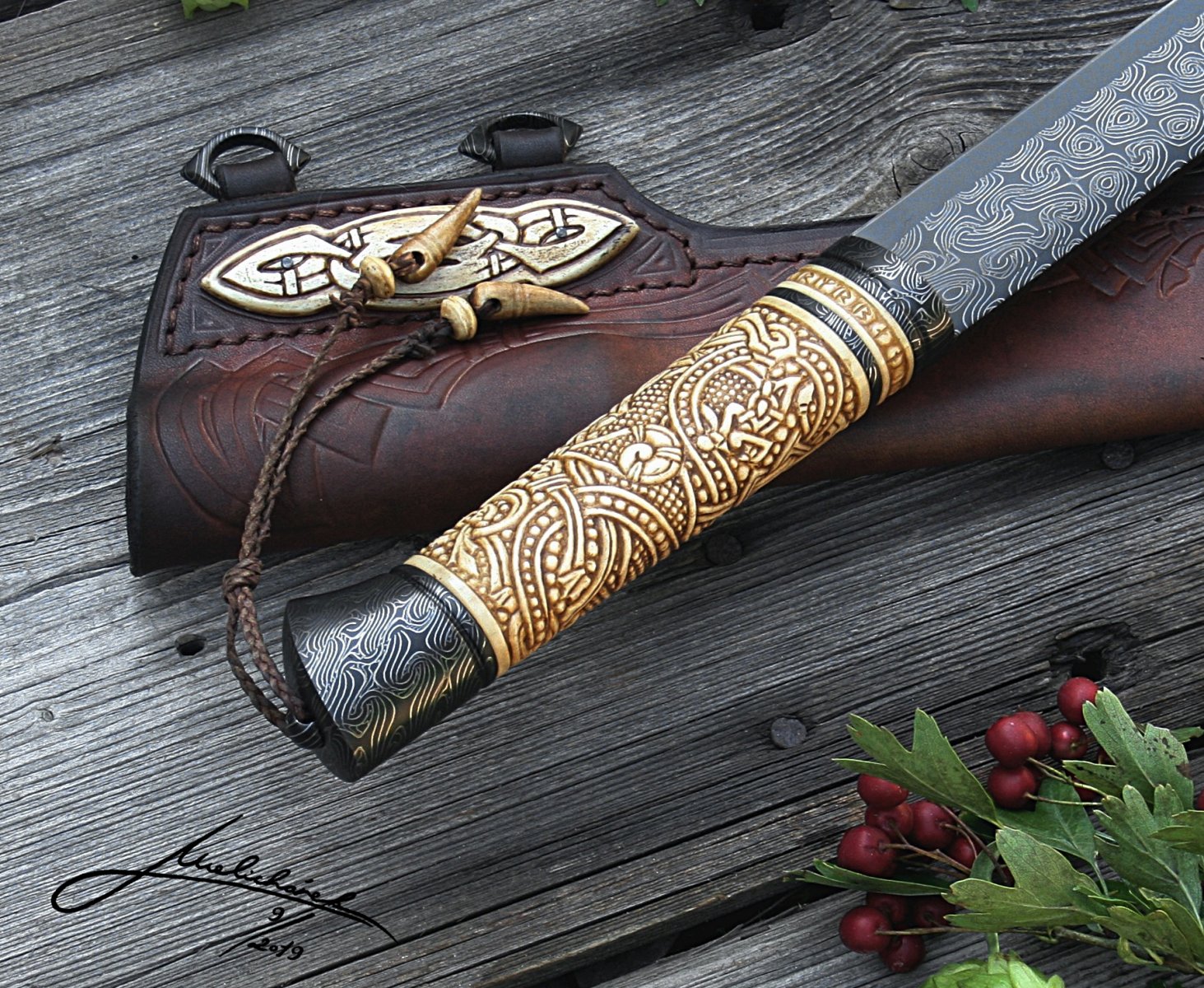

Hi everyone
After more than five weeks of work I finished this mytho-poetic interpretation of viking war knife. It is not according to any real historical weapon . It is just inspired by various historical pieces and my fantasy over that theme
The last picture is not my lame intention to make nude art, but it is more likely for get an idea about the size of knife

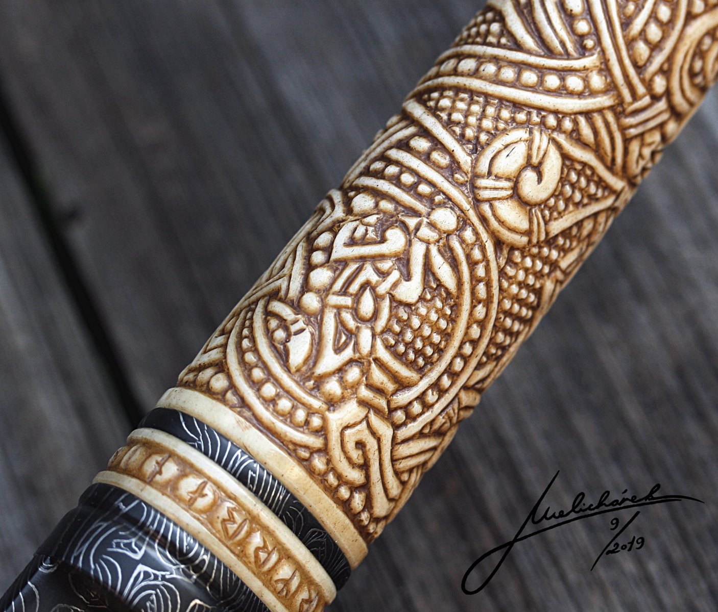

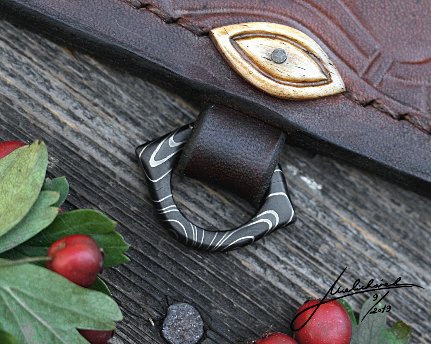

The Serpent eye was the main symbol for me during making this knife. On the blade, there can be seen eyes changing into the serpents. The stars should represent the Lion pelt. On the handle, there is an engreaving of the Lion facing the Serpent. The runes say something about Serpents eyes, death and fate. Symbols of eyes can be seen on the sheath too.
Well thats basically it and I will see you soon with more knives
thanks Petr
NADIRAX
Blade - multibar twisted damascus steel 1,2842 (O2) + 75ni8 Uddeholm (15N20) , added edge and spine 1,2842 (O2)
Guard - multibar twisted damascus steel 1,2842 (O2) + 75ni8 Uddeholm (15N20),
Handle - carved bone
Average length - 52 cm (approx- 20,5 inches) , blade - 35cm (approx- 13,8 inches).
Blade width at widest point 35 mm (approx 1,4 inches) , blade thickness 5,5 - 4,5 mm (0,217 - 0,177 inch) - distal taper.
