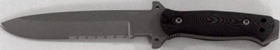

I Made these for a Capt. U.S. Army in Korera
they maybe an Idea for you..
he liked them and ordered more.
I'd build him one along these lines with a 5-5.5" blade, fairly thick.
Made and sent alot of them out in the last 10 years.
