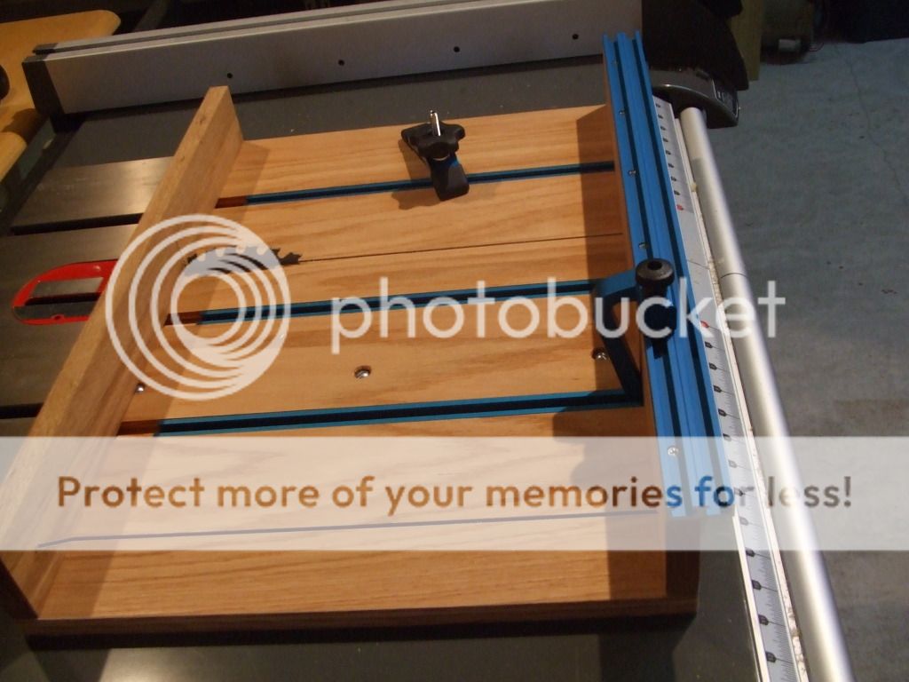

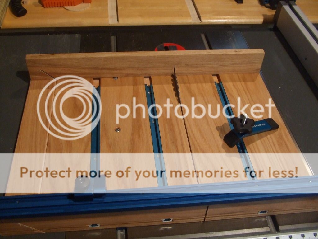

I use my full size table saw with a sled to cut my handle material including bone and have had good luck with this. Below is a pic of the sled I built.

The tablesaw is a great tool, but it is not the safest tool to be processing small blocks and scales on. The general rule is that the piece you are cutting must be long enough to reach the riving knife/splitter behind the blade before the cut is completed. If the piece is shorter than that, you need to use a jig like the sled shown by plas62, or use a different tool. If all you are going to be doing is making small blocks of wood into scales, a bandsaw can be a safer tool to use. A Japanese handsaw would be less expensive, but making more than a few cuts at one time in material like ironwood or cocobolo will be a fair imitation of work
