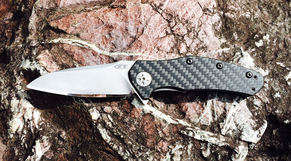

Thanks for the replies guys. Here is a photo of my Dragonfly 2 (in ZDP-189 steel) after the Sharpmaker and some stropping. It is very sharp. Slices through paper and shaves. But I just wanted to get a pretty mirror edge on it. I guess from the responses, I just need a better sharpening system with more gradients in grit. Can the standard Edge Pro system and the kit they provide achieve a mirror finish?
The EP is good for mirror polished edges, although if you're going to be sharpening stuff like zdp-189 you might want to just get the basic kit and then buy some other diamond stones for the tougher steels. I did all of these with Venev diamond stones, Boride SiC stones and leather strops w/ diamond compound.
Again, it is up to how high mirror you want to have.
The highest grit the most advanced Edge Pro Apex system provides is #3,000 (tape).
It gives a mirror-ish finish but not as pretty as those edges you see here.
This ZT was finished with the #3,000 tape.
You can still see some fine scratches.
If you want high mirror finishes, you need something more (probably something like diamond suspensions at <1 micron).
Their #6,000 tape may be good enough, but I do not have experience.
I can see the factory grind on your edge.
So you need to start from low grit stones to wipe that off.
Their #120 is silicon carbide and should work well for that purpose.
But their other stones are mostly aluminum oxide, which is softer.
As said above, you may need to get additional grits with silicon carbide, cubic boron nitride, or diamond for the high hardness ZDP-189.
If you are not familiar with the stage type sharpening system like Edge Pro, you may be better off with a clamping system like KME and Wicked Edge.
It takes some time to get consistent results with Edge Pro with multiple stones, and you need that to get to a mirror edge.
I am sure that it takes some time to learn any system, though.
