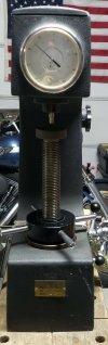

I have a chance to buy this HR-150A ROCKWELL HARDNESS TESTER. It's in good working condition and can be delivered, set up and calibrated to me home.
Add says diamond indenter included...
What do you all think?

Hi, looks like the standard Chinese unit, you can see some reviews and how tos on YouTube and Google. From what I understand they are quite reliable units. If you don't mind me asking, what is the price tag? I would probably think half the price of a new one would be fair if everything works as it should.
I suspect that's an older model of the HR-150A. Can you read the date on the tag? I wouldn't think it mattered too much about the age as long as it's in good condition. As mentioned price is important - having it delivered to your home, setup and calibrated is worth something. They're not hard to setup or calibrate once you know them a bit.
A new indenter isn't very expensive: https://www.amazon.com/dp/B08YN2H8MF/ $22 shipped, and there are some on ebay also.

The guy selling is asking $550, but may be negotiable. I may be able to get it setup in the cost?
Its reasonable, I think these machines are around $1000 new. If its not too far, you could pick it up, let the vendor show you how to use it and test it against a HRC hardness block in the range of 60-65 HRC couple of times to judge the accuracy of the machine. If you are willing to pick up, maybe you could negotiate the price some. Check the youtube vids how the machines are operated to have an idea.

I've got one I use - ordered it for a spare. I can switch between them and not tell the difference, doesn't even need recalibrating. Remember, these cheap Chinese indenters are what's put in the HR-150A from the factory. No reason they shouldn't work just fine. Perhaps I lucked out? OR, you just happened to get a lemon? Does calibration take care of the difference in reading?
I bought it for $500. He performed two tests on it at his house with a 65HRC test block and it was very accurate.
For that price he is delivering it, setting it up and calibrating it for me. He's keeping his test block set though...

I see test blocks for $90 to $150 range. I would assume I only need one at around 60 HRC?
If your machine works good, yes. I would prefer to have at least two, maybe one in lower (61/62) and one in higher HRC (65/66) range. A small plate of precision machined D2 at full and tempered hardness measured against 2 other devices would be good enough IMHO for personal/hobbyst use.

My calibrated test disc came in today. It's calibrated at 62.2 HRC. I did three test and the results were, 61.9, 62, and 62.2.
I'm happy to say the least! Now I just need that Evenheat to get here!
