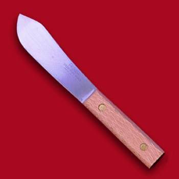

I've made a number of these knives using the Green River blades. I think a more modern pattern, the Green River Belt knife would be more suited for a modern day hunter. It seems to be a hybrid of the two knives you mentioned. I think 52 - 55 might be a little soft, particularly if you differentially temper the blade.
Seems like you might be talking at cross purposes. The imagined knife of a frontiersman as a fighter-bush-knife seems like would be a different tool altogether than something practical for dressing deer. I wonder if you might want to consider a pair on knives: a larger trade knife type and a smaller skinner type, or some such?
I wondered about that, I just found someone somewhere online saying that knives of this period were in that range. But I don't know if this person knew what they were talking about. And I didnt really know what practical concerns this would raise for a knife that is meant to be used.

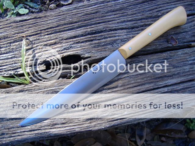

The pictures of originals you show there were of English scalpers. Three small iron pins, and tapered, or untapered partial tangs were the more common design. If you will notice, the pin holes are drilled low on the tangs. This allowed an oversized grip to be installed and yet have the pins appear as centered. It would seem that grips were mostly of one size fits all. Grips varied from oval, to hex, to faceted octagon. The wood could be beech, most common, to boxwood, or reddish SA hardwoods. For a good all around design, I would choose the French type with it's dropped point. The French most commonly used two iron pins, larger in diameter than the English, at about 1/8", but about the same handle shapes. Both French and English often copied each other in order to compete in certain areas of the country. The Green Rivers did not appear until the early 1840's.
I have heard about the French drop point scalpers, but I have yet to find any pictures of them. Do you know where there are any online, or perhaps something that at least looks similar so I can see if it would be well suited to my goal?

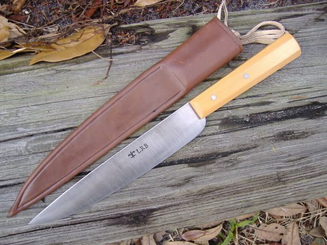

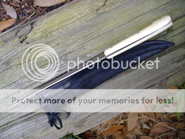

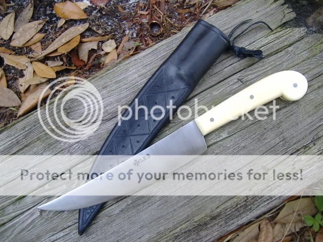

The first photo is copied as close as I could get to an original French scalper. This one has the oversized grip which overlaps the lower edge of the tang. The second photo is a copy of a copy rendered by one of the leading experts on French trade knives, and is probably my best selling model in scalpers, although the first in the photos was the most prevelent type. This design has the grip finished oval and the grip matches to the tang edges evenly. I suspect that the original it was copied from might have been altered by the owner. The French trade scalpers were apparently always made with a tapered tang, and most often with two iron pins of about 1/8" in dia. The English can be found either full thickness or tapered, but still usually a partial tang, and used pins of about 3/32" at most. These blades are about 1 1/4" wide, by 7", by 3/32" in thickness. The French leaned toward 3/32" to 1/8" thickness, while the English ran from 1/16" to 3/32". Both of these designs are 18th c., but carried over into the 19th c. The English most often filled the grip overlap with a cutlers resin of pine pitch and brick dust. The French did not bother with the gap.
LRB - Those are a couple of nice knives. Is the back sewn sheath period and nationality correct for the scalpers?
barnett25 - I think the HRc is correct for the time period for most of the knives. Although the range probably varied more widely than given. A modern day user would probably prefer HRc in the 57 - 59 range. Some of the best knives of that period could have reached that hardness.

" LRB - Those are a couple of nice knives. Is the back sewn sheath period and nationality correct for the scalpers? "
The back center seam sheaths are the correct type that were imported with the knives, but may have been an optional accessory. The originals are reported to have been made from about 4oz. leather, then given the Cuir Blouilli hardening treatment. For extra safety, I use 6/7 oz leather with the CB treatment. These sheaths normally had no belt loops, and were either just slipped between a belt and the body, or tied to the belt with thongs. These below have been stained black with vinegaroon stain as I belive most or all were. The knives are English style. The top one being more a table knife. The lower a typical English scalper with boxwood faceted grip. As to acual measurements of originals, the French could be tracked down in many cases as their guilds were pretty strict on specs, but I am not that sure on the English. Probably very close to the French. The smaller versions seem to have had about 5" blades. The mid sizes around 7". The ball grip version below has a 6" blade.

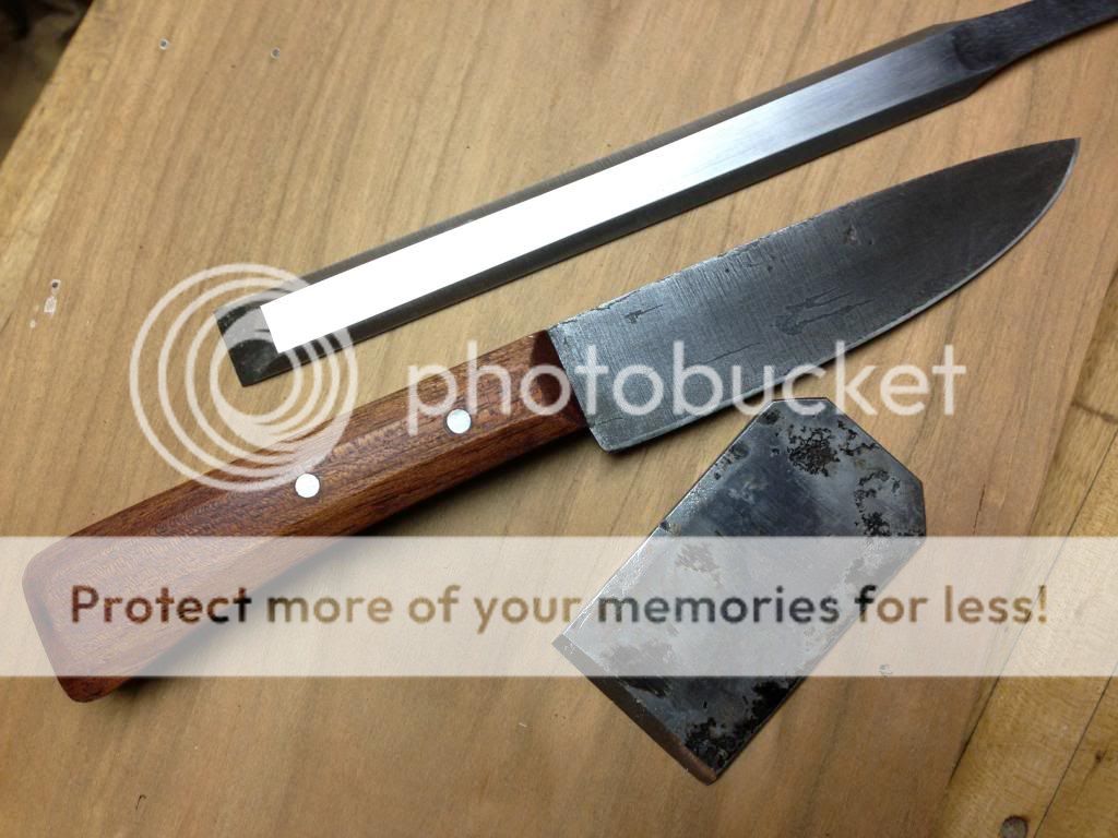

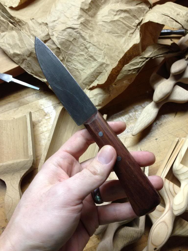

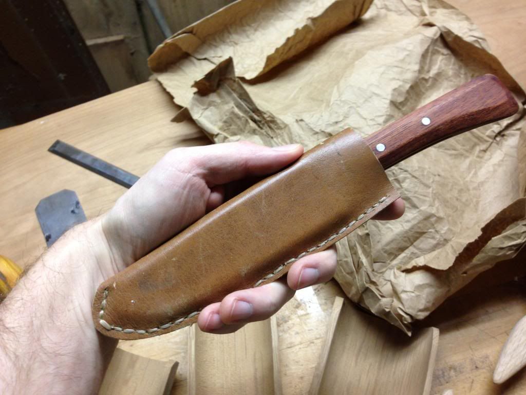

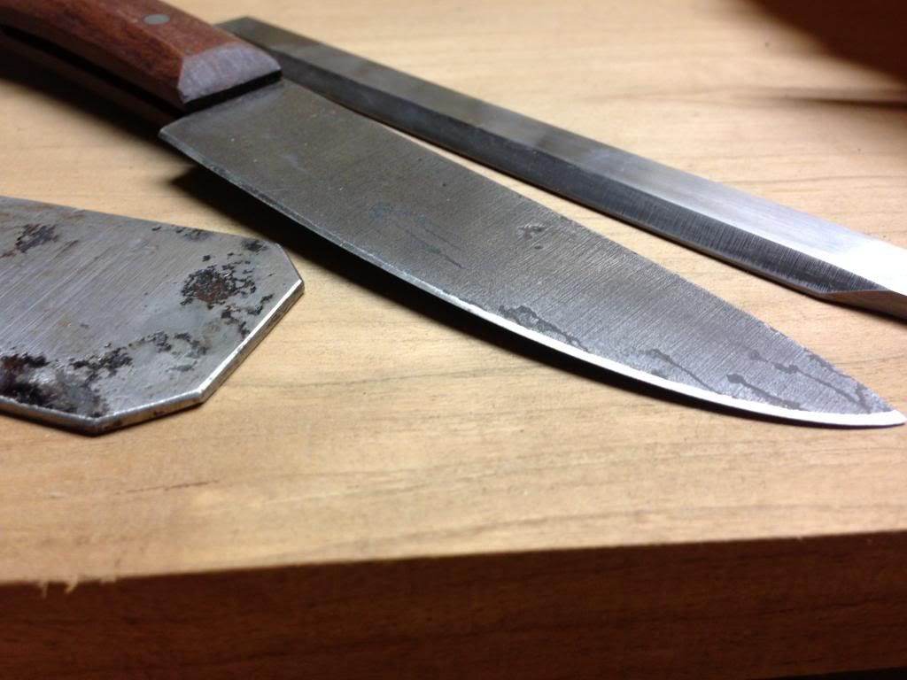

I hope I don't get in trouble for resurrecting a thread this old, but I finally decided to sit down and post the results of the help this great community has provided me in the past. Here is the trade knife I gave my father for christmas in 2011 as a result of this thread. I actually made two, the other was for my sister's boyfriend. I forged them from 5/8" x 1/4" 1084. It has a short, tapered tang with two rivets that hold the blade in a bloodwood handle. The shape of the handle is my interpretation of a historically accurate octagon design, but reworked a little to align with my own personal design preference.
The blade was flat ground on a 4x36 sander, then I aged the blade using a blue and bleach process.
I made a wood sheath with a leather wrap. The leather is actually from an old pair of boots my dad got as a gift from his father when he was young. The leather was not veg tanned, and was pretty rotten, which is why I used the wood insert.
My Dad keeps his on the wall, but the other one gets used as an EDC (much to my surprise). Although the leather has torn on the sheath, the knife itself is apparently holding up just fine. Considering these are the first knives I have heat treated at home by myself I am pretty happy that they have held up. I can probably thank Aldo's easy to HT 1084 for that.
Thanks again to everyone that helped me out with this project back then. I promise the next project I work on won't take 2 years to get posted. ;)
