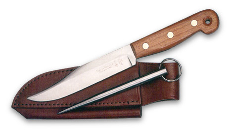

Different styles for different tastes, beauty being in the eye of the beholder. Myself, I like sweet simplicity. Ran across this one outta Sheffield, England the other day, and was immediately smitten. In the process of "plagiarizing" one from a file right now. I'll even gin up the accompanying marlin spike out of a large round file, and leave it hard enough to be a sweet chakma.;)
