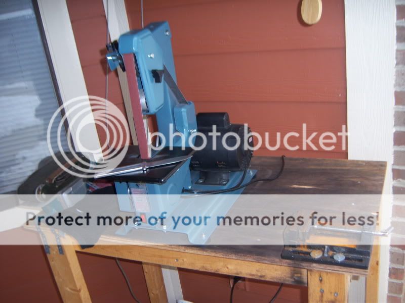

First, a pic of the new grinder. She's my baby. (I know this is nothing compared to most of your guys' but I'm a broke SOB with a girlfriend that scrutinizes every spent dollar) :)

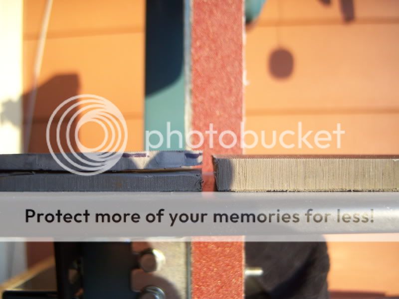

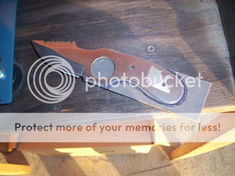

I drew out a basic profile on the rubber and then cut it out. I actually used the blade I was tracing to do the cutting. This stuff is a perfect combination of being soft yet tough. You don't have to be perfect and you actually WANT it over-sized for sanding down flush later.

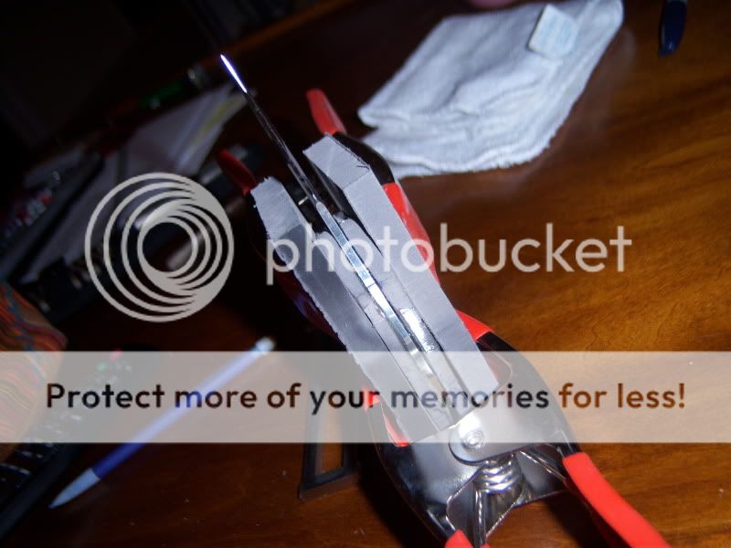

Now, I missed the photo op for the actual epoxying. It started setting up faster than expected and I got rushed putting it together. First, surface prep by roughing up the knife handle with coarse sandpaper then cleaning/drying it. Make sure to use the machined side of the neoprene against the knife. Basically you mix up a typical 30minute epoxy, spread it over the knife handle, attach one side of neoprene, flip it over and spread epoxy this time filling in the holes in the handle to create 'epoxy pins', then clamp it in between something flat. I used 2 of the un-used neoprene scales. Again, be liberal with the epoxy. If some squirts out the sides, don't worry, it will be sanded off later. Let this sit overnight.

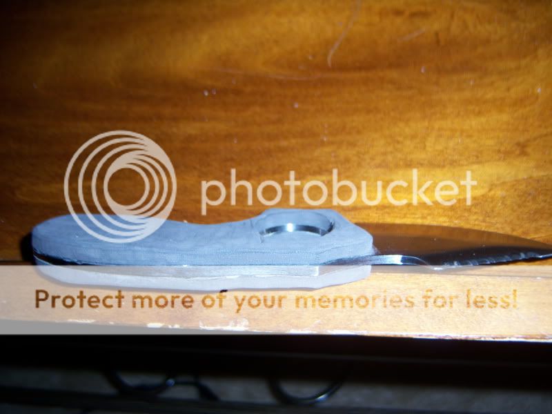

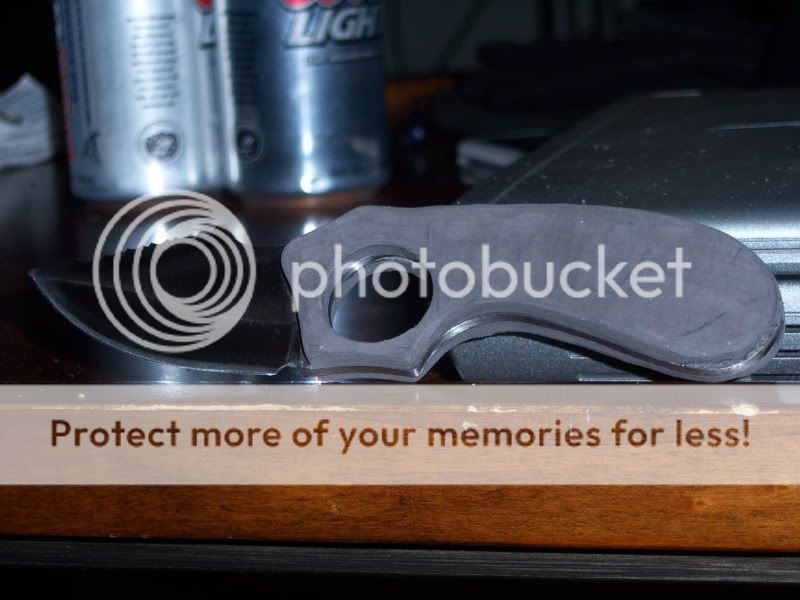

After it has cured you can begin to file, grind, or sand (60-100 grit will work fine) the basic outside profile, of the rubber, down to the metal of the knife. I used my brand spankin' new grinder but in reality, it was overkill. This stuff can easily be formed by hand with regular sandpaper.
Yes, beer makes everything better. Even knifemaking. It's common to cut, scrape, burn, or set yourself on fire while making knives. Beer tends to lessen the pain somewhat. =D
From there just knock off the square edges and start making some ergonomic contours to your liking. I finished up with 400-grit sandpaper but as long as it's over 300 and under 600, it should look good. The site says NOT to polish so I would just take their word.

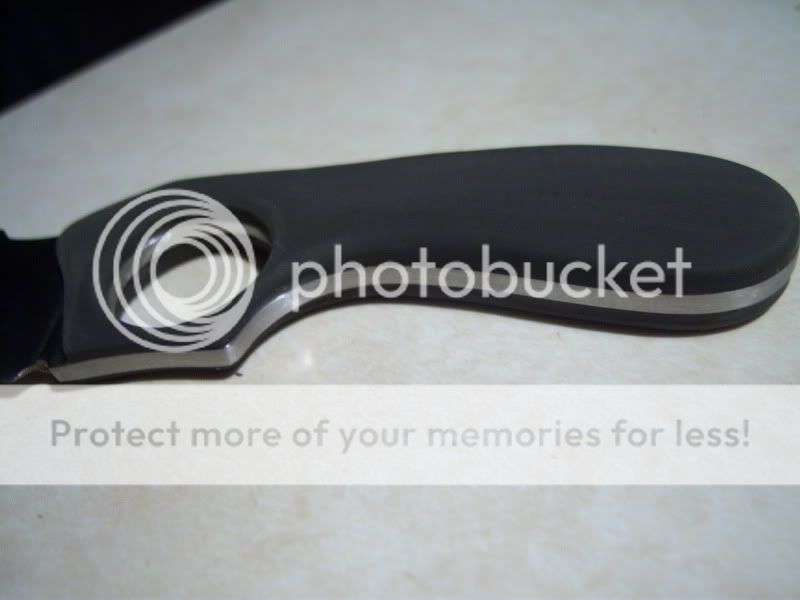

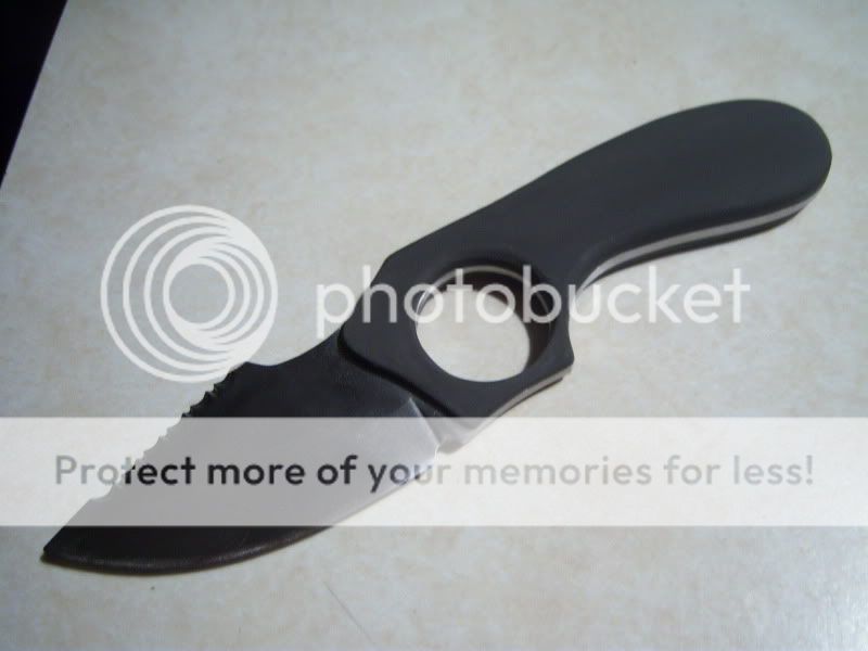

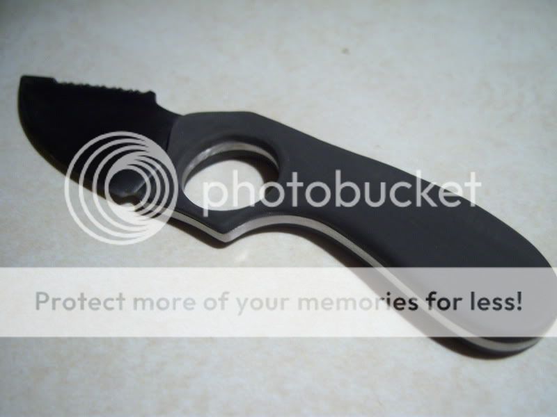

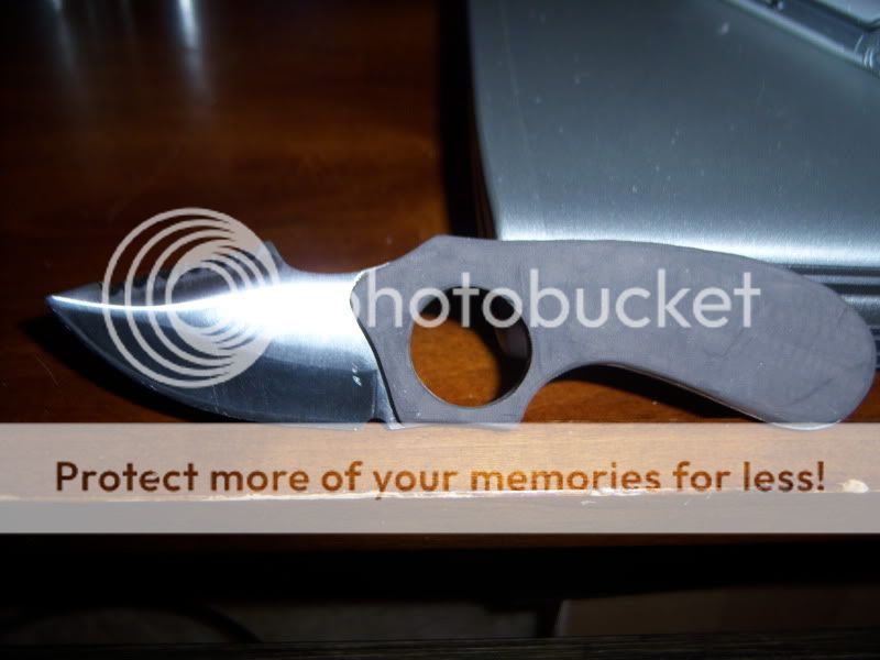

Here are a few finished pics. I really love the feel of this stuff. It stays 'grippy' even in wet or cold conditions. Perfect for diving, skinner, kayaking, and camping knives. I don't understand why more people don't use this stuff!? Maybe it's because it doesn't look AS nice as the other materials, but I think it looks great.

Very interesting. I wonder how it will hold up. Is it "grabby"? I don't like that property myself.
If the epoxy doest hold use flexible adhesive they use for car molding. I found you need something a bit flexy since the scales aren't quite rigid. It's good stuff though!
I make neoprene handles for skinners and fillet knives. Everything you said is right.
It doesn't take a smooth finish, and the looks are so-so....but it won't slip in a wet/bloody hand. I use a black epoxy made for bonding rubber to metal. I think the maker is Hysol? K&G used to sell it, but doesn't anymore, IIRC. I'll check this evening and see if that is right. I tried the rubber adhesives used on cars, and the neoprene adhesive used to repair wet suits. Neither would hold the metal very well. I drill lots of large holes through the tang, so the epoxy bonds the rubber together. No problems so far.
Could you show us how flexible the material is?
I would have drilled a few more holes in the tang, but with a flexible scale I wouldn't expect the bond to pop off like it would with something hard.
Yea, it is a little bit 'grabby' but maybe not as much as you would think. Once its been worn in a bit and got some hand oils in it, I think it feels awesome. I'm the opposite though, I don't like super smooth 'slick' handles.
I ordered a few more of the same knife after some friends drooled over it, haha. One of them paid for 4 blanks in exchange for me making him one! Woot woot. I intend on drilling several holes in the next ones. I'll look into those adhesives, too, since these are now essentially 'customers'.
Hmm, I'm not sure how to show the flexibility. The scales at 3/8" thickness could be bent 45 degrees without much effort and when I cut it in half to 3/16" it was very easy to bend.

Ok I am sorry but is that a 1''x30'' grinder?
If so you can get one for 45.00 from HF, and with a 20% off coupon you can get it even cheaper.
@hkpokes- Yea, I don't know why I had it in my mind that using blanks was bad. Its a huge time saver. I think I just felt like I couldn't call it something I made in the end.
No problem guys, thanks for the comments and suggestions!
@bigern- No, it is a 1x42" and way stronger than the cheap HF one. These run between $150 and $300.
