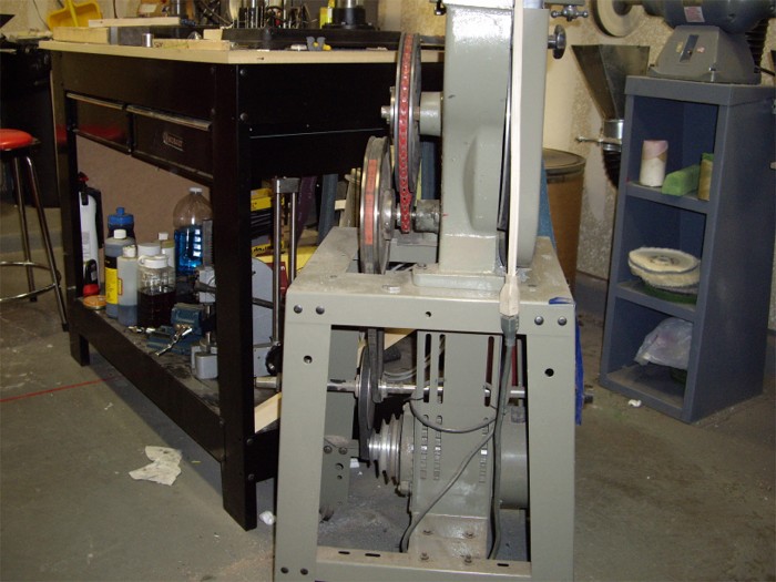

I acquired an old 14" bandsaw that had been a woodworking saw. I built a base for it and added a mechanical speed reducer and the necessary pullies to slow it down to about 90 SFPM. You can do this with pullies and belts on a jackshaft or chains and sprockets or a speed reducer.
I have a good bandsaw for wood and a large horizontal bandsaw for metal cutoff, and the 14" converted saw. I really like the converted saw for cutting shapes in metal and for cutting antler and bone. I use it for all the little things I previously used a hacksaw for.
You will not regret taking the effort to slow that saw down to use for metal cutting! There are many ways to do it, it doesn't make much difference. For me the the speed reducer was given to me and I like fabricating things. For others the electronic method makes more sense and gives flexibility.
