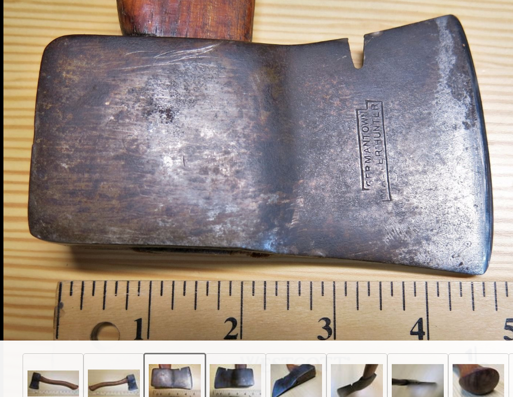

Well, I bought a Germantown Master Hunter on ePrey.
Head is really nice. It seduced me.
The 13 1/2" haft is a fright. 1/4" short of fitting the long axis of the eye, top and bottom. Bends 3 degrees off true for it's top half as it leaves the eye and 10 degrees off true for the bottom half. Grain perfect - perfectly horizontal. :o The single wood wedge is driven in between the haft and the side of the eye.
The eye is 1/2" x 1 1/2"
Any suggestions for a source of a replacement haft?

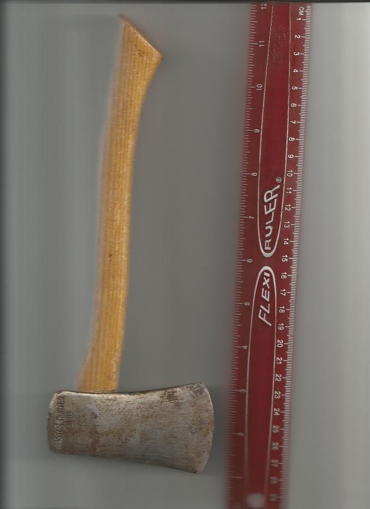

Perhaps the original handle looked like this one (around 10" overall length):
...OAL is just over 10", blade is 2 1/8" worked really well for deer processing last fall. Seems to hold a good edge. Blade says master hunter No.110...

The axe:

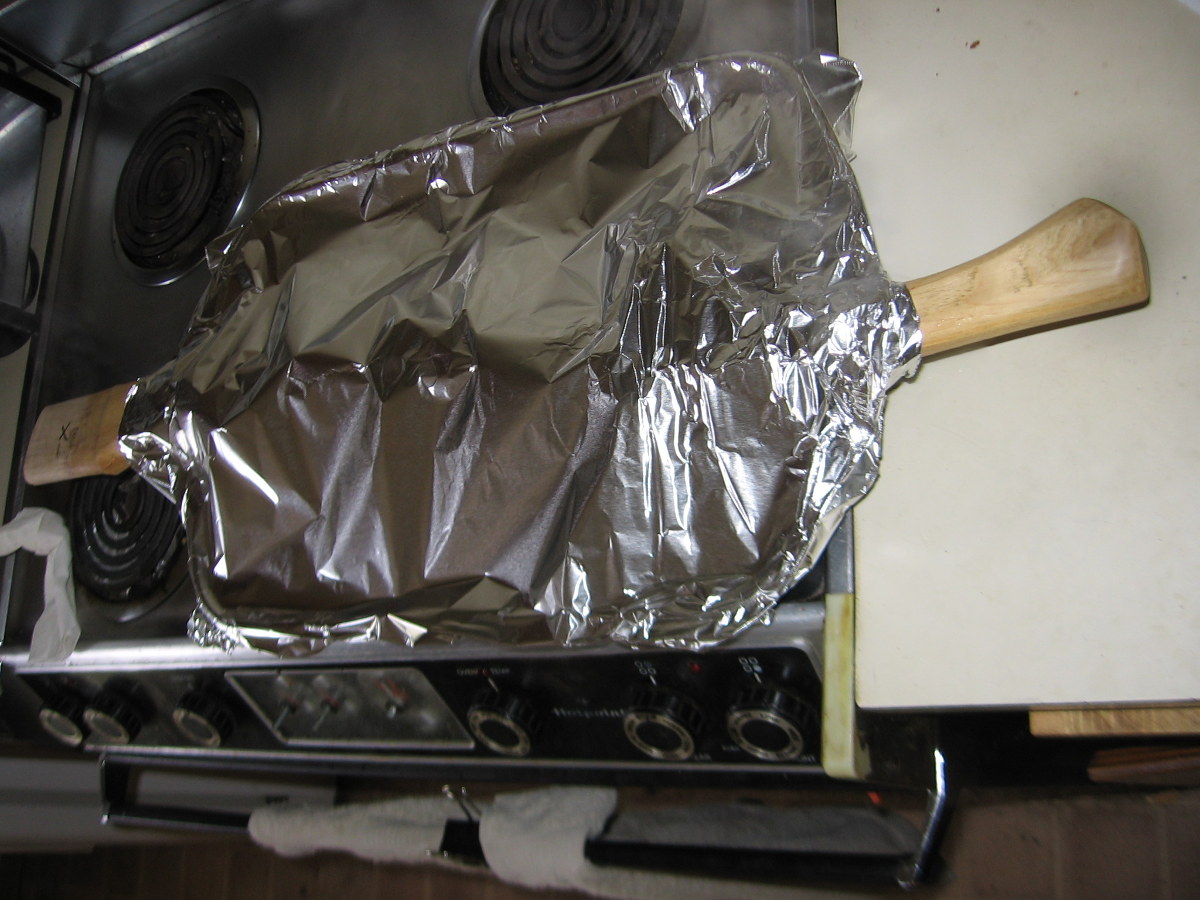

Is it practical to try to straighten the bent haft? I have straightened arrow shafts and removed dents from rifle stocks, but never tried to take bends out of an axe haft.
You can straighten a haft with steam. Give it 20 to 30 minutes of steam and then clamp it a little past straight. It will rebound some when you release it the next day. I've bent them too far and had to straighten them back the other way. I've also had them where I didn't straighten them enough the first time.
The steam is just to spread an even heat all around the wood. You don't really want it to be absorbed deeply into the wood. For this reason I always seal the haft with multiple coats or BLO or tung oil before steaming. You'll still end up raising the grain some but you just sand lightly and refinish.

. . . Give it 20 to 30 minutes . . .
I totally immerse the haft for at least one week in the mixture prior to the oven. I like to have the haft in the oven at 350 degrees for a minimum of 12 hours. Admittedly my method is much more time consuming. My thinking being that well seasoned and longer oven time are key.
I have developed this technique over many years of trial and error and consider it highly secret. I would appreciate it if It did not go beyond this thread. TIA
