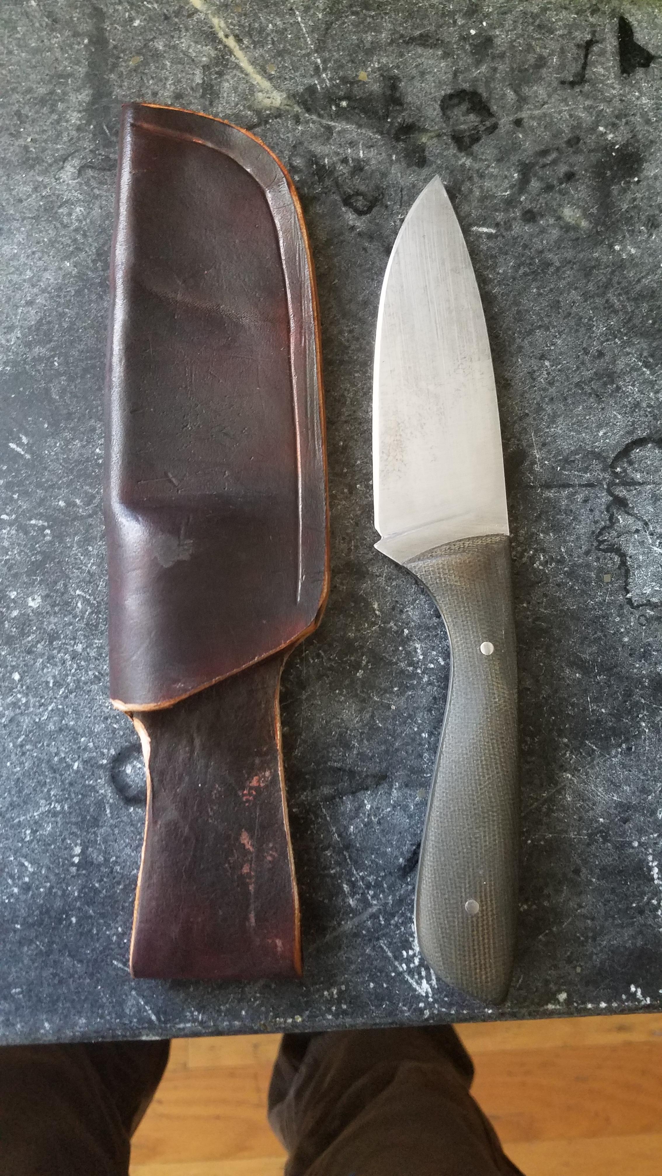

Thus is my first blade that dosnt feel like practice. The sheath is still in progress. It's for a friend. I gave it a scotchbright finish but the patina has already started. What's the best way to finish it that will look right. Re-scotchbright or full patina?
Also any points for the next one are much appreciated. Don't spare my feelings☺
I would give it another scotchbrite finish then oil/wax before giving it away. Then explain to your friend that it will patina(better than rust) if he uses it and that he should either force a patina(you can help) or suggest the wipe clean and dry and oil/wax before storing away....You want to show off how good it looks FIRST then allow it to age!!
it looks like you did not put oil on the blade right after you did the finish on it ? when the metal is raw from being finished, even a finger print can show up a few days later after it starts corroding the metal. it needs a protectant. when you go to epoxy your scales on, clean the metal wth acetone or alcohol to remove the oil, and re apply oil after the epoxy sets.
Leaving corrosion on the blade when you give it away is just not a good way to put your best foot forward. Someone that is not a knife maker will look at it difrently then then we do. If thy want a patina then I let them do it, otherwise it just looks tacky.

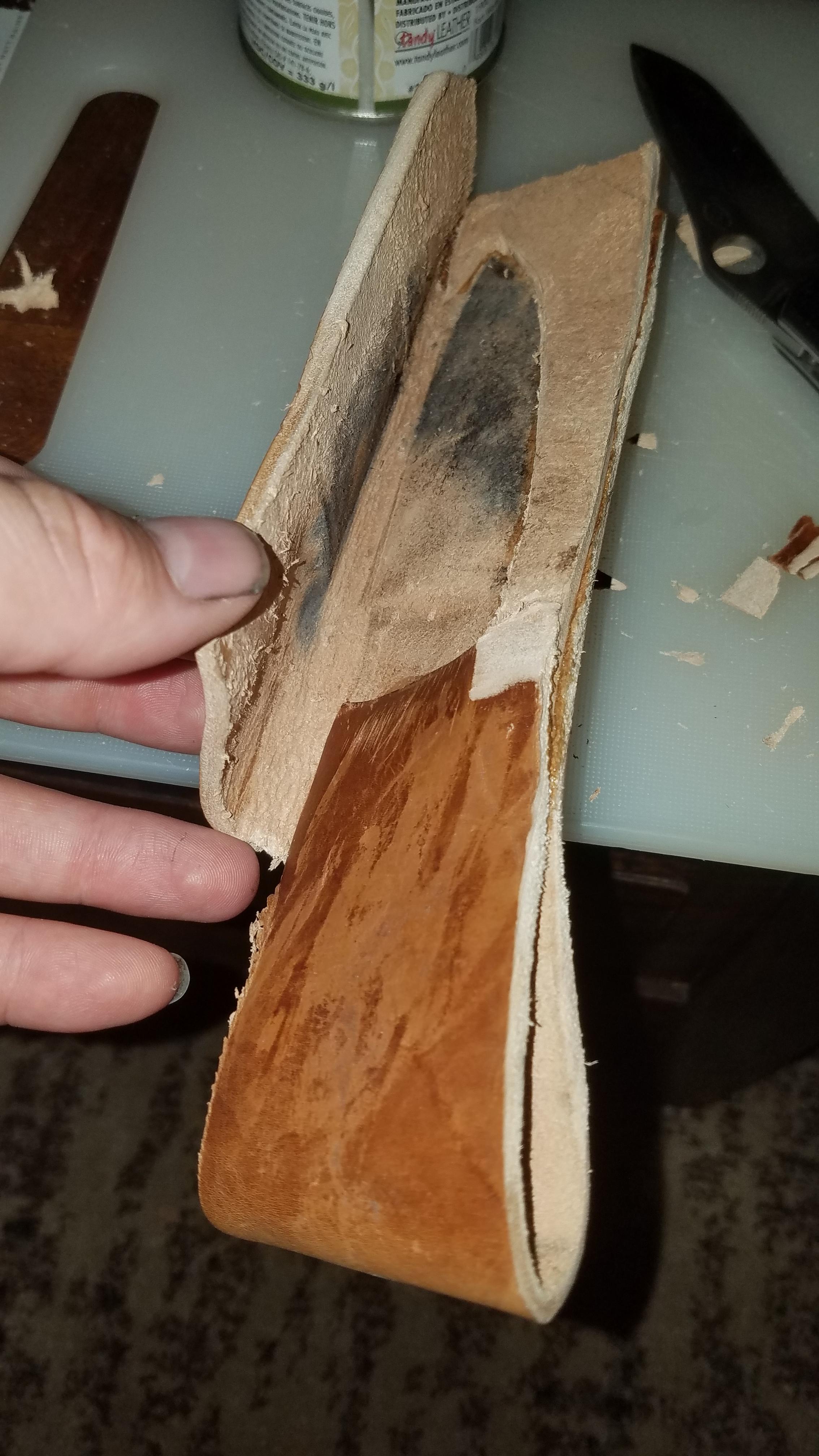

Did you put a welt in your sheath? If not then your edge is going to cut the stitches.

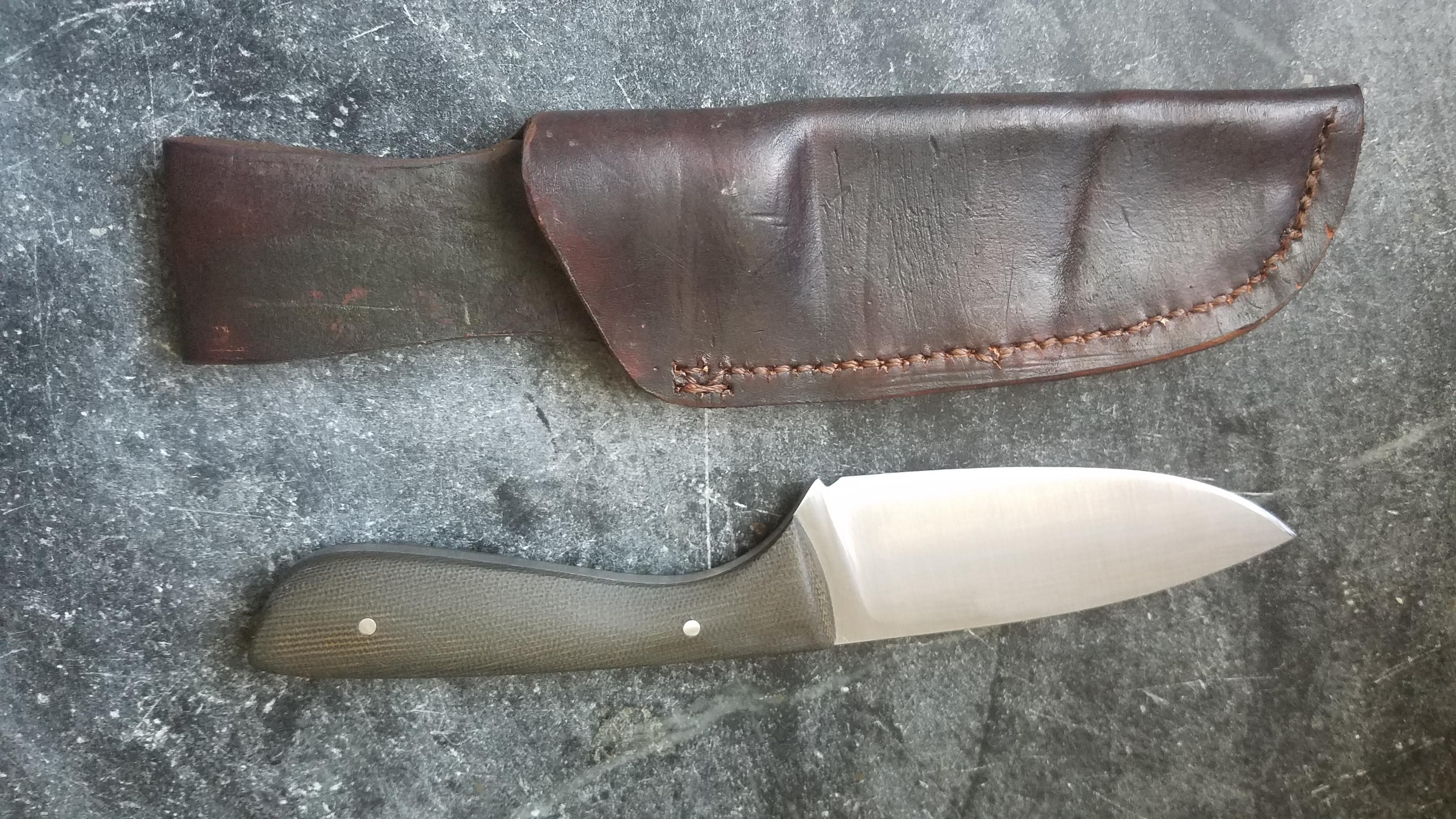

Looks great compared to my first grinding attempt. Congrats I am sure your friend will love it. How many practice knifes did it take to get to that level of skill?

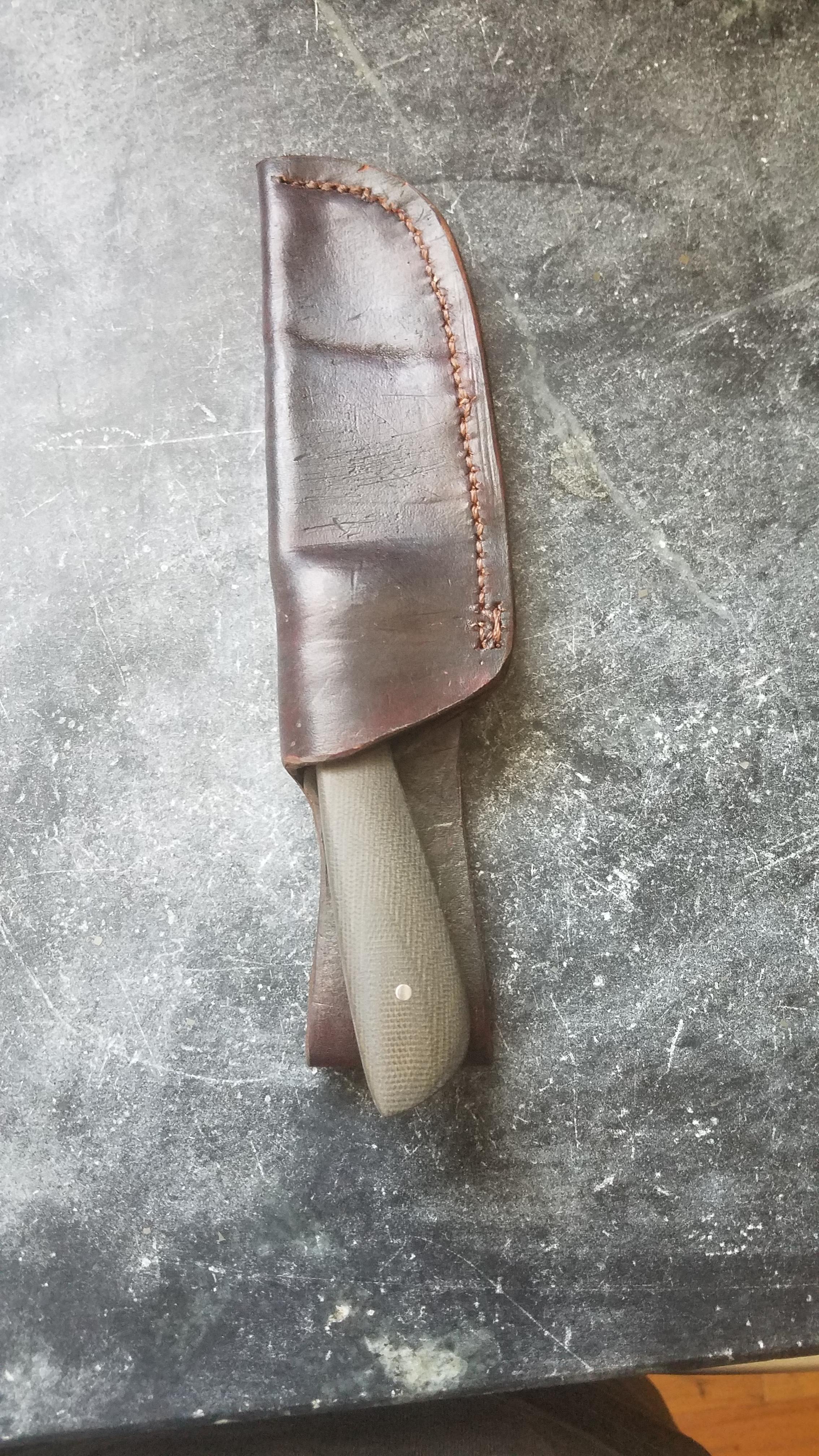

With regard to your sheath, it is a little "boxy" looking. Use your knife as the pattern for your sheath.
Lay your knife down on a manila folder laying the spine of your knife on the spine of the folder and trace the outline of your knife onto the manila folder. Then, move that line over about 3/8 of an inch away from the line you drew for your knife shape, making the knife shape of your knife a little bigger. I would imagine there are YouTube videos that will show this better than I can explain it.

I cleaned it back up and stiched my sheath.
The sheath is "functional" I guess but definitely not a work of art. I think I'm going to get set up for kydex since I'm not really enjoying the leather work thing right now.
The knife looks much more presentable. Your friend will be lucky to have it. Kydex sheaths are a good idea but don't give up on leather. Leather work is like anything else. There is a learning curve. Once you get the hang of it you'll see it's not so bad. And a well designed and executed leather sheath is a lovely thing.

Next time you wet form a sheath (for a carbon steel knife) wrap the blade and some of the handle in some seran wrap. The wraps onto the handle will help anchor the blade wraps in place a bit.
A few times around and some tape on the edge will keep it dry enough to allow the sheath to dry and not tarnish the blade.
