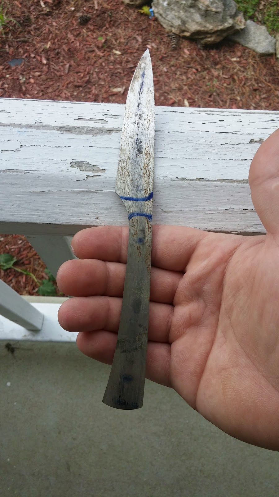

Here are a couple more patterns I profiled yesterday.
Alpha Storm. Little knife, no lanyard hole, a hair under 5" oal. This one was requested by Ronnie several months ago.
Little Horn. I had 8 of these already profiled in 0.070" AEB-L before the Dart batch. I totally forgot about them. I'm going to chisel grind them. I'm thinking high end scale material on these little gentlemen's knives. Elephant ivory, mammoth ivory, mammoth bone, lacewood, stag, fire hose micarta, ebony, etc.
This one is just for me. It's a steak knife. I think I need to knock a half inch off the handle. I have no idea what I want for handle material. This is 0.060" 15n20.
