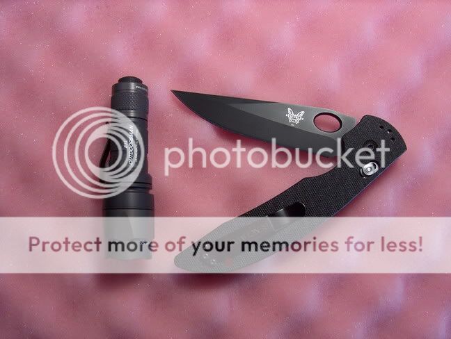

Well I just got home and ripped open the packaging for my new Surefire E1L Outdoorsman and i've gotta say its an awesome little light.
Here is a picture of the E1L with my current favorite EDC. :)
