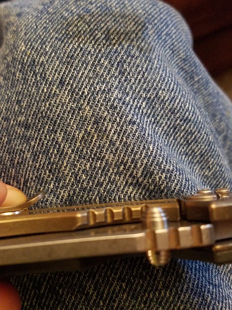

I've read about strong and weak detents. With the very slightest amount of pressure on my lock bar, it depresses detent into hole and gets stuck. This renders thumbstud useless even if your fingers are cleared of lock bar. When you use two hands to open it, it takes lots of effort and you can actually hear it click out of the detent hole. It is very disappointing on a $425 knife. Is this normal? I've not read one story of this even during break in periods.

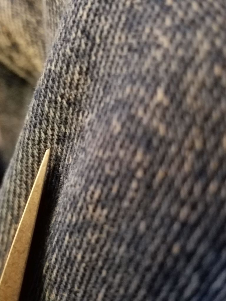

Next is the edge grind. It is clearly 2 different angles and at the tip it looks like a chisel grind. I'll edit with a few pics shortly.

This one is lock bar sticking in detent hole with no pressure on it
This one is tip. Sorry for the picture, this was the only way I could get it to focus.

I'd send it back. That grind would bug me and a non flipper shouldn't have a real strong detent though that is definitely odd on a Hinderer

It's more than slightly. Maybe the picture didn't do it justice. When you open the blade and shut it without touching anything, the lockbar sits in its proper position. Slightly in the detent hole. With the slightest pressure it goes deep in the hole and stays. It doesn't pop back out to its normal sitting position. Just removing the knife from pocket depresses it in the hole to the point it takes two hands to open it. I wish you lived closer to handle it. I think you would understand if you manipulated it with your own hands.

OP you described it clearly so no need to repeat. It sounds to me a defective xm-18. No frame lock knife, flipper or nonflipper, should have a detent hole that will suck the detent ball so tight such that it would require two hands to open. I tried to press the lockbar of every framelock folder of mine (when the knife is closed) and no one snudges; all would open single handed effortlessly.

I think I have to sent this one back. I could honestly probably make due with a two handed knife. But that grind. I also have a dealer an hour away trying to get some of these so I will get with them and maybe get to handle a few and get one I'm pleased with. I can handle that grind on my paramilitary 2's, but not at this price point. I had such high expectations.

I think Hinderer at one point (and maybe still occasionally) drilled the detent hole in the blade a hair too big and it let the detent drop "into" it instead of resting in it. It made the blade very sticky to open - impossible with thumb studs and requiring a lot of effort with the flipper. My 3" wharncliffe does it although I have to squeeze it just right to make it happen so it's not a big problem. I feel like I had another one at some point that was even worse (can't remember which one and I must have moved it on at some point). This is not the kind of stiffness that breaks in with use and I can easily imagine it being unacceptably stiff.

The grind would bother me, though.
