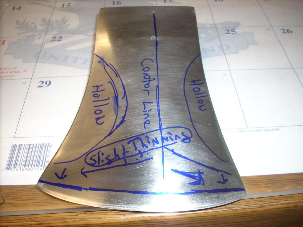

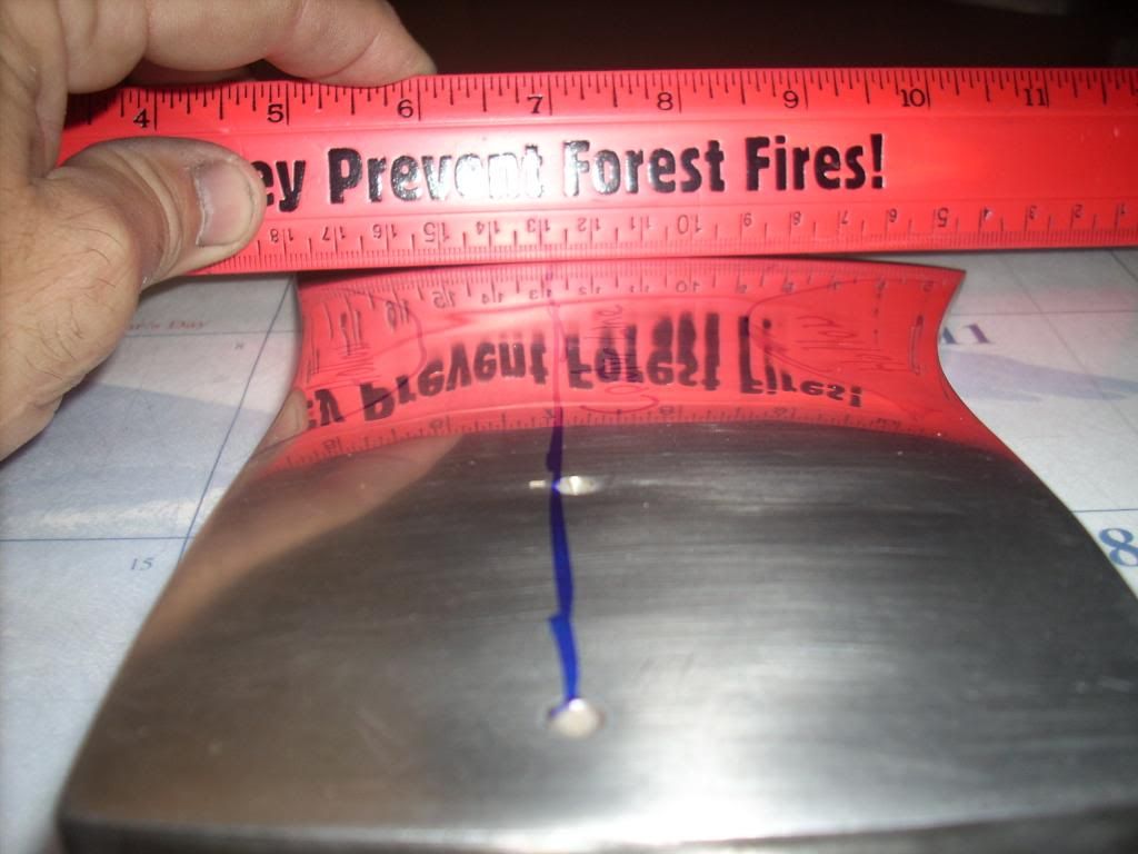

The half moon shape is a result of putting a bevel on an axe with a high centerline. That means that the bit is thicker in the center than at the to and heel. Also referred to as "convex cheeks." Look something like this:
When you put your edge bevel on an axe with a high centerline, you naturally will need to remove material further up the bit in the middle since it is thicker. If you remove too much metal from the toe and heel, they will be very easy to damage. If you end up with the crescent shape on flat cheeks, then you probably ground it pretty weird. Here's a picture that demonstrates it marginally well:
Ok, this is where a lot of my misunderstanding was coming in I think. I thought convex meant it curved our from poll to bit, however convex here refers to it curving out from toe to heel. Does concave / hollow cheeks mean the same or does the follow go from poll to bit when they mention that?
Again that makes perfect sense now. Two follow up question though...is the peak / fattest part of the crescent correspond to the center line? Is this why on moosecreektrail's arvika grind he drew the triangle towards the bit, to determine where the crescent should peak so to speak?

Notice edges of chisel, slightly less on edges,
For trail Work the Banana Grind Is a little thin, as we cut thru knots, dead wood, Green wood,
On some axes like Tuatahi are ground flat with a slight high center line, So the chisel grind is more uniform along it line from toe to heal.

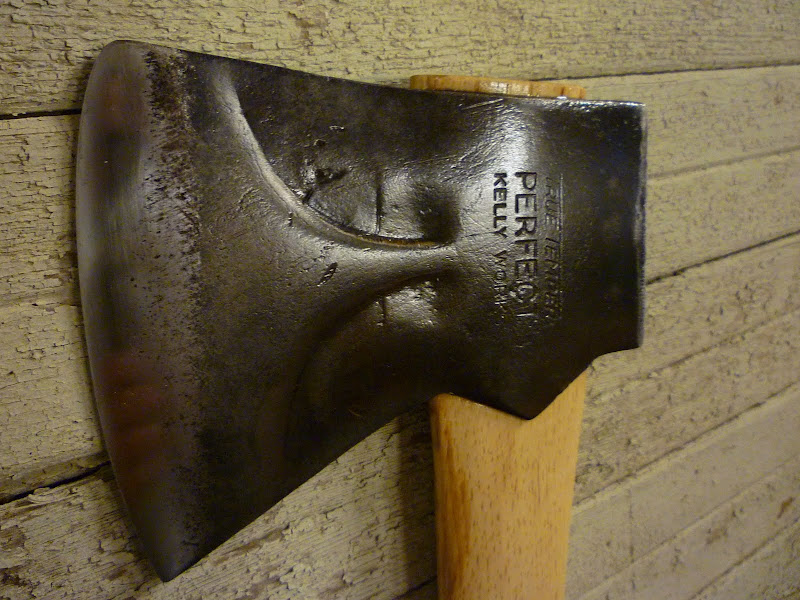

I've thought about trying a reprofile on this big Jersey, the one on the left:
It's a Kelly Works World's Finest, and I've been hesitant to grind on it. Seeing your pics is making me want to try it more!
^^ that's a beautiful kelly perfect -- what weight? looks bigger than my 4lb'er.
Also, +1 on the blue-and-white-crew sharpening page -- thats what I got started with.
I don't have that Perfect anymore. It was somewhere in the 3.5 to 4 pound range. BTW, those two pics are not the same axe. The top pic (profile shote) is a Legitimus Connecticut pattern.
