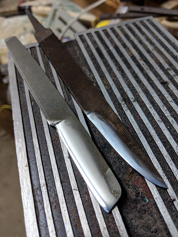

Not generally, unless you are buying a knife blank that you just handle and sharpen. You mentioned you don't want to heat treat, do you have a grinder of some kind that you intend to use? If your files are at 72-74hrc than shaping will be tough. If you can get the knife shaped as you want you will probably want to at least temper it in the oven a bit to make it less brittle. Better yet, do that first before grinding, then keep the blade cool while you are shaping.
Yeah, that's the method I'm doing. Just tempering and keeping the blade cool while shaping. Here's what's I've done so far. These will be for whittling.
