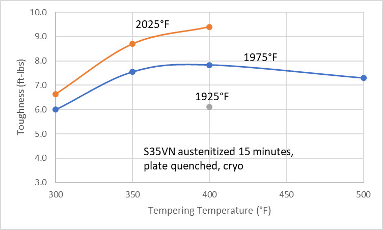

S35VN is technically tougher, but it is not super tough, more wear resistant though. AEB-L at higher hardness will give you much more toughness and similar wear resistance as niolox.
Look at the graphs at the end, even though the whole article is good.
From this article by the same guy (graph under stainless steel section), it’s a slightly newer post than the one you linked.
