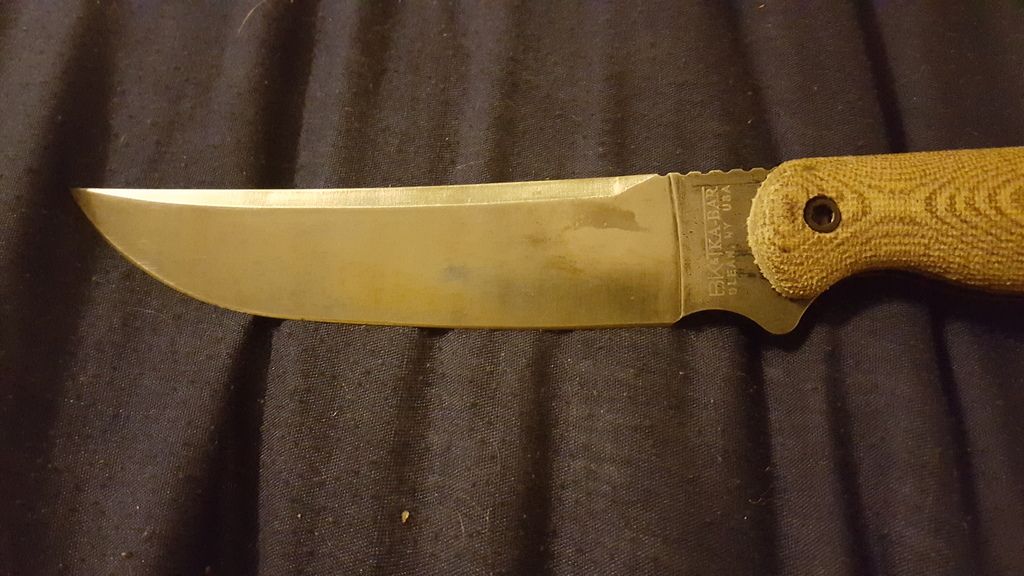

Y'all prolly consider it a noob question but if I strip my bk 15 will the logo still be on it?
ive heard yes for older knives no for the newer knives so how do I tell if I got one that the logo will still be there ?
ive heard of people acid etching the logos any one have instructions on hand for that?

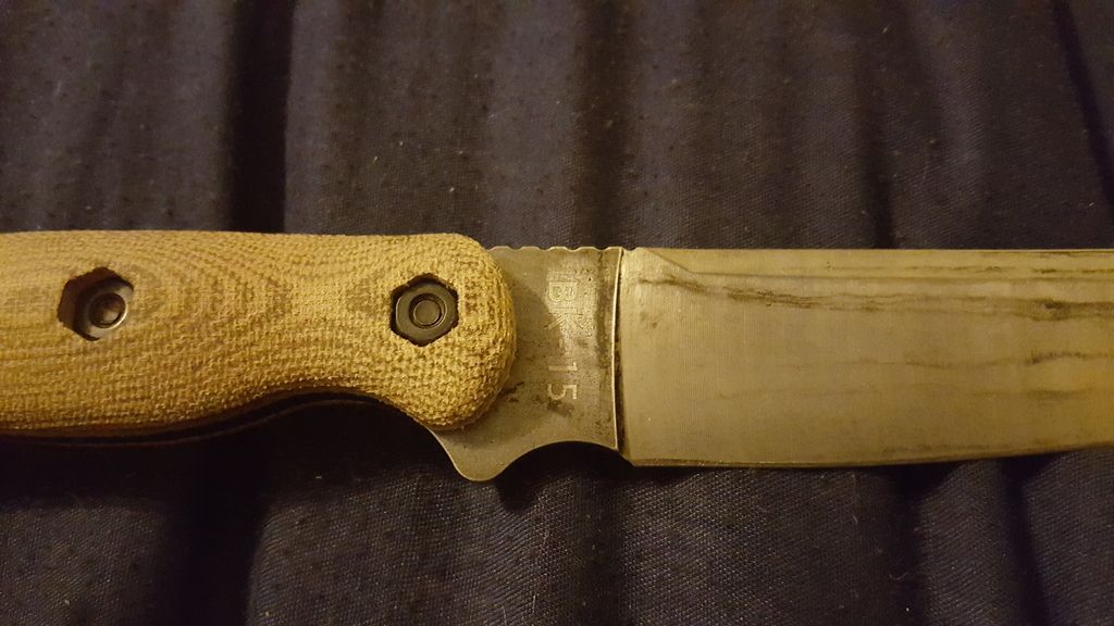

I've stripped a few of my laser etched Beckers and the logo seems to be quite visible afterwards. I've never etched them deeper, not because I don't want to but simply because I'm a lazy butthole. JWAW's picture above shows pretty clearly that the logo will remain..
The logo will be visible yes, but as the knife gains a patina and discolor it will get to the point where you can no longer see it. The thing with the older knives is that the logo was physically stamped into the steel. If you want the logos deeper into the knife you can either electro etch it in or use pcb etchant. There are plenty of threads around here about both methods.
You'll know the difference bud. Lasered versions have the logo 'cut' into the coating. Stamped versions have the logo pressed into the steel.
Okay well it's gold and looks like just the paints been removed so I need to etch it any good tutorials out there?
You can chemically or electrically etch the logos. To etch it chemically find some PCB etchant (ferric chloride) and dab it on the logo. Wait a while, then wash it off. Repeat as necessary to get as deep of an etch as you want.
