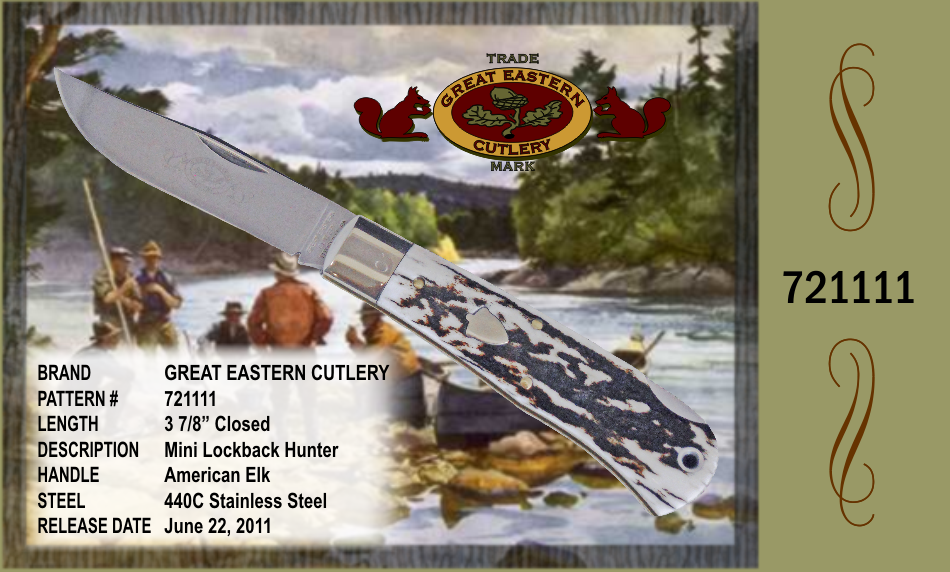

GEC made the 72 in stainless in at least two blade shapes.
Sourced from GEC #72
Good luck on your search.
