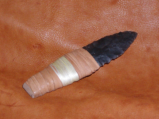

This was my attempt at an obsidian look. I didn't spend as much time on this piece as I had wanted, but have had people see it and instantly say "wow is that made out of obsidian". So I guess it fooled a few.
I have went further - actually have a test plate with different attempts need to get a picture of it.
[/IMG]
Let me know what ya think.
JT Sure would like to see a pic of your knapped steel blued. After looking at it again it really does look like a carefully knapped flint or obsidian tool. To where mine looks maybe more like obsidian in a natural form.
