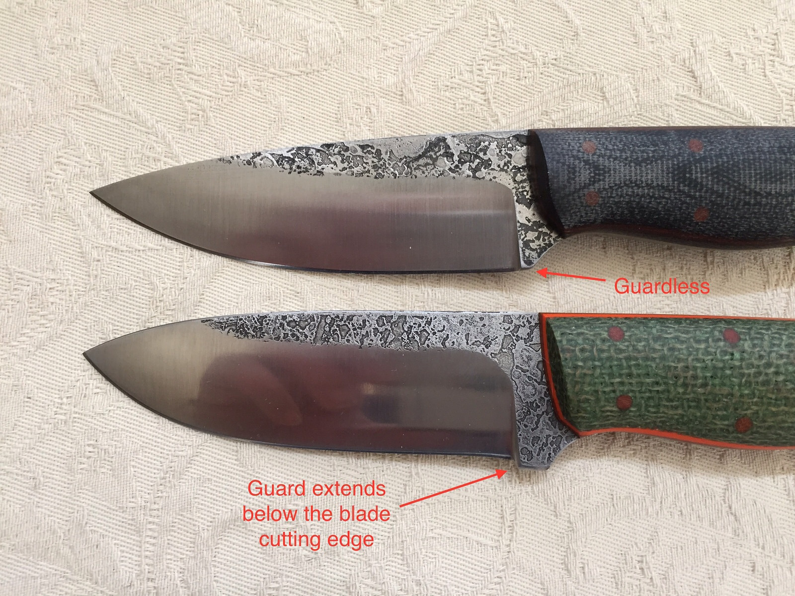

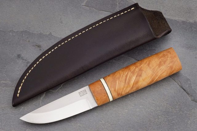

I've always believed that a guard is one of or a combination of the following - a portion of the handle, a separate piece of furniture or the actual ricasso of the blade that guards your hand from slipping onto the blade when working with a knife. So basically a puuko blade (see pic below) is guardless.
Question time.
First off- Is a guard a simple matter of opinion or is there an actual right or wrong definition of a guard?
Second- If the ricasso is even with the cutting edge, does that make it guardless? Even if the ricasso goes well past the handle actually guarding the users fingers from being cut during use. See pic below.
Third- What in the heck is a guard? Pics really help.
This is my definition of a guardless blade.
Just to save the trolls some time...
Not sure about an actual technical definition of guard as it relates to knives, but to me both of those forge-finish knives have guards. The bottom puuko does not have a guard. That is just my crazy opinion, tho!

To me both the top two would be considered to have a guard in the sense the blade is lower than the handle and offers some degree of protection to your index finger versus what you have pictured in the last photo, well second to last, not the british guy. I have never seen guard used as a technical term, each piece is usually called by its individual name. I do see what you are saying about the second one because the ricasso is wider and drops below the edge. I would actually like to know if that is considered a quillon? At least by ABS standards.

I would call the top two knives "dropped edge" knives where the design functions like a guard.

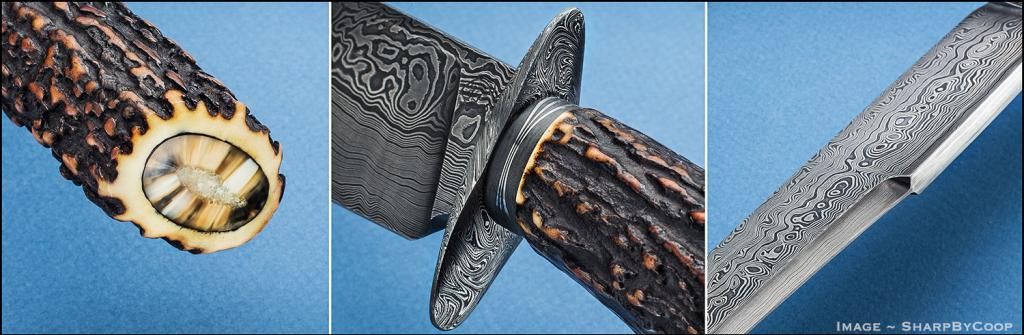

A knife making site.net says that a ricasso is the flat space before the guard (coming from the blade). The guard is "The term for the cross member attached to the end of the handle, next to the blade itself. This prevents the hand from sliding onto the blade." This has always been my understanding.
A guard is a separate piece of hardware to protect the fingers/hand. In some cases where a blade is forged or of a special shape the guard can be integral. However, a large finger choil is not a guard in my opinion.

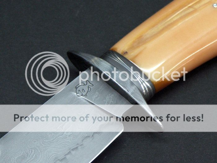

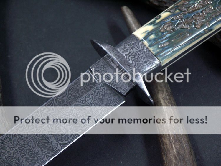

Here is a classic guard, Joe.
I would also consider a deep indentation in a handle such as seen in the Bark River bravo series an integral guard, if pronounced like in the top knife of the three.
IMHO the Fiddlebacks shown here have no guard. They just have a deep ricasso. Except if the scales in the bottom one in your photo followed that up it could serve as a makeshift guard.
