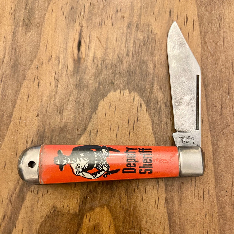

Here's the image of the knife in question:
Welcome Katlery!
This is an old Imperial trick knife but the handles are likely similar to what yours once looked like (they were available in a large variety of colors):

Be careful, I'm 5 years into my history lesson about good old knives ;) There are literally dozens of different colors that your knife could have looked like. The Imperial "Hammer Brand" were "cheap" knives back in the day but the "bones" of the knife were put together very good. Usually the blades maintain their "snap" and they hold a nice sharp edge.
What made them "cheap" is the construction of the handles, instead of having to pin on jigged/stag bone or a nice wood handle like the more pricey knives at the time, it is easier and less expensive to have a one piece side (the shell handle) that snaps into place. These one piece sides generally had a celluloid plastic wrap cover that would be applied to the shell handle and then they would be snapped into place. This made it easy to have a vast variety of colors and patterns. The one I show below is from the same company that made your knife, just a little older. You can see on the end of the colored portion that there is a gap and you can see this is the edge of the celluloid wrap. I could actually peel off this red color wrap and then it would like your knife with the all metal shell being exposed. If you Google "Hammer Brand Pocket Knife" and scroll through the pictures you can see the variety of colors and patterns that Imperial made in the past. It's pretty cool :cool:
