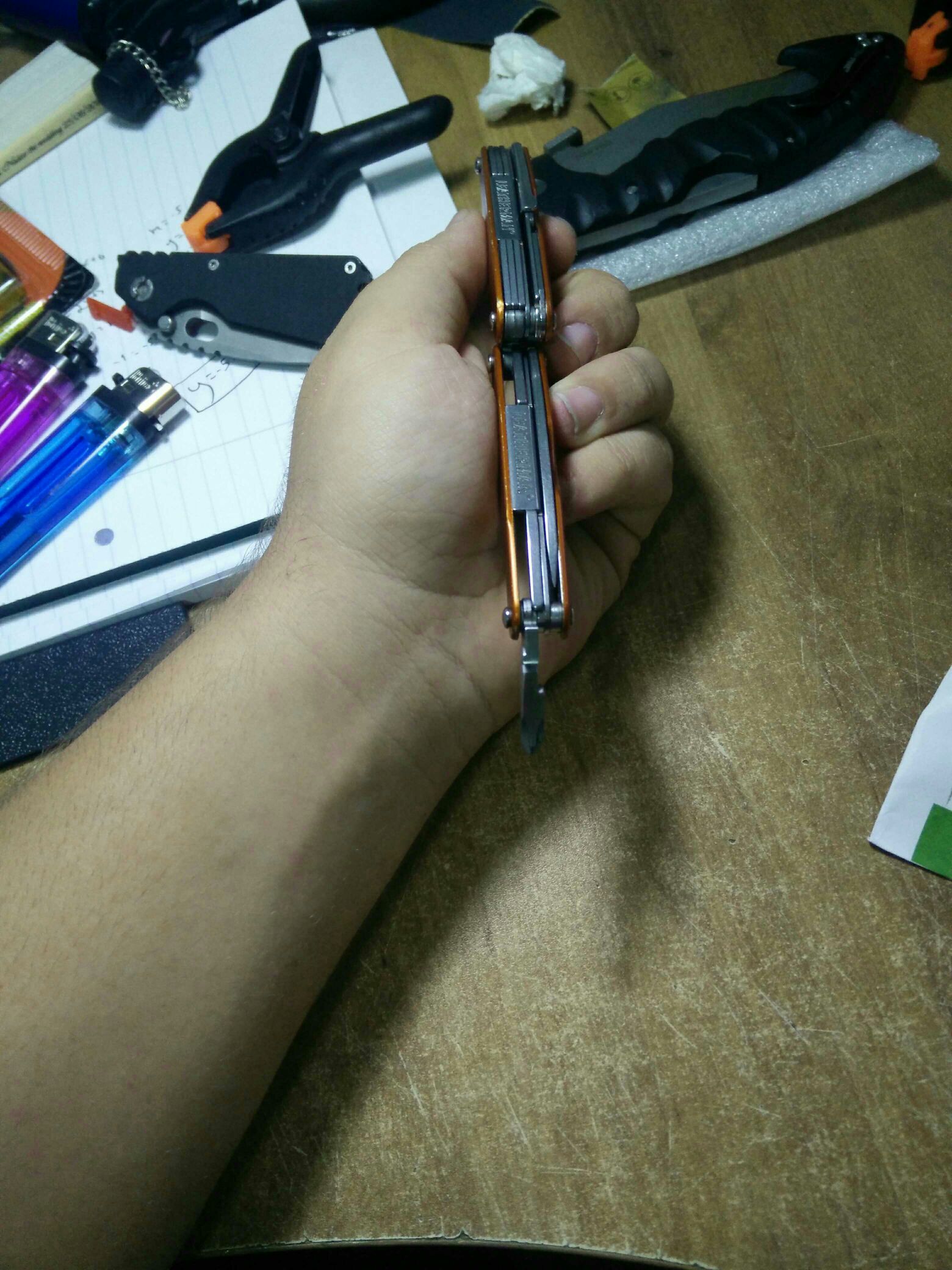

Hey,
The juice just arrived in mail but the Phillips head screwdriver does not have a back spring (like all the other tools) and the seller doesn't know why.
It is suppose to be like this? And if not, can I install one myself?

No, it's not supposed to be that way. At some point the backspring broke and wasn't replaced or repaired.
I suppose you can fabricate or replace it yourself, or you can possibl7 inquire if it might be covered by LM's warranty... I don't recall hearing of them ever turning down a warranty repair.

Absolutely the best warranty, ever. They never even asked for proof of purchase. People used to take advantage by buying a beat to hell user for next to nothing and sending it in, getting a new one back at no charge. Time was you could send in roadkill and get a new cat back :D . But I think they tightened up things lately. Even so, I believe they would fix yours. Send it in and see what happens. Ask for yours to be repaired rather than replaced, unless you prefer the newer version.

I prefer the old model too, but have the old Juice S2 and the new Juice CS4. Here are some pics of the phillips driver spring from both. I'm assuming the new S2 springs are similar to the my new CS4. The springs are VERY similar in dimension. However, first hand, the old S2 springs look a little thinner. However, it may just be that they radiused the edges more on the older models, giving the appearance of a thinner spring. If you sent yours in I don't know if they could replace the old spring with a new one. It might be possible, but I don't even know if they would attempt it. You might want to ask them.
