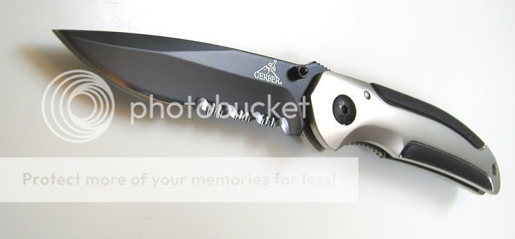

Another popular folder was the AR300. I picked up a few several years ago for a great price and have used them as gifts. They also are light weight, the rubber insets make the knife feel comfortable in the hand and the blades have a beautiful finish on them. As for the steel blades themselves, Gerber has been using some really crappy stuff. But unlike the Paraframes, they seem to cut okay.
