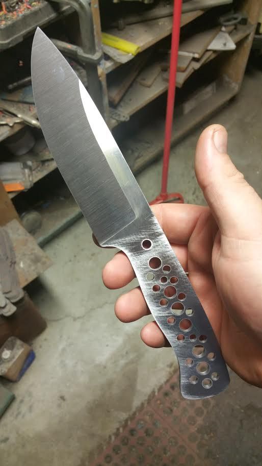

I sat down today and sketched out what I have had in my mind for this "One Knife".
Now remember that I plan to have an axe as my main heavy duty chopping tool.
This knife is 11" OAL with a 6" Blade.
I plan to start on a couple very soon.
They will be made from some 3/16" O1 that I have on hand.
I like this design Chris. IMO, you've got exactly what you are looking for here.
Scott

Here is a picture pre heat treat
Weight is just over 9 ounces here.
Hopefully after tapering the tangs and gluing the scales on they will remain between 10 and 11 oz.

Looking good! Looking forward to the finished product once all the final decisions are made.
