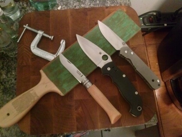

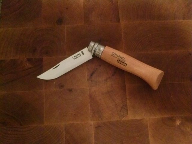

Last weekend I hit the big 31, and for my birthday my wife got me an assortment of knife stuff, cigars, whiskys/whiskeys, in short... Guy Stuff! One of the great gifts she got me was an Opinel No 8.

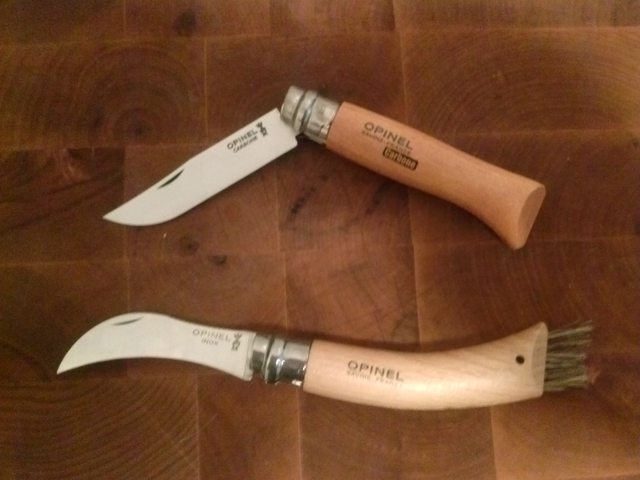

So here it is straight out of the box.
Next to my Opinel mushroom knife (which she previously got me as a gift... seriously an amazing woman)
I am not a huge fan of the finish, or the "carbone" handle logo (a bit too modern looking for my taste) not to mention the issues people have with wood swell, so I decided to mod it a bit. Some sanding, boiled linseed oil, etc.

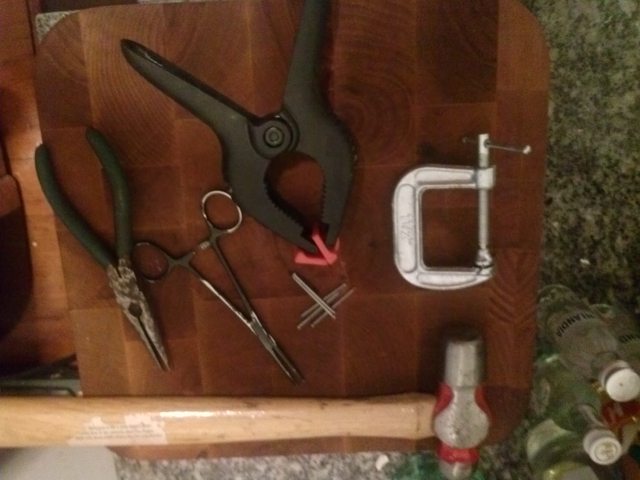

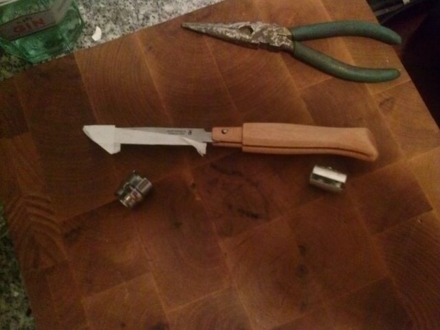

the tools i used.

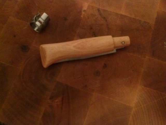

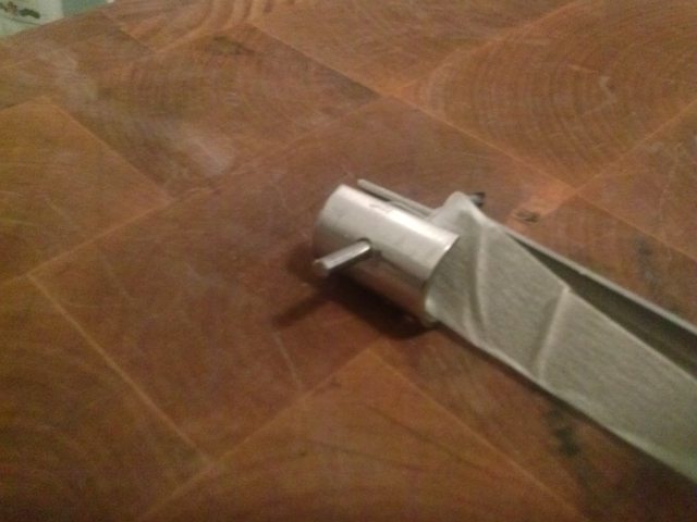

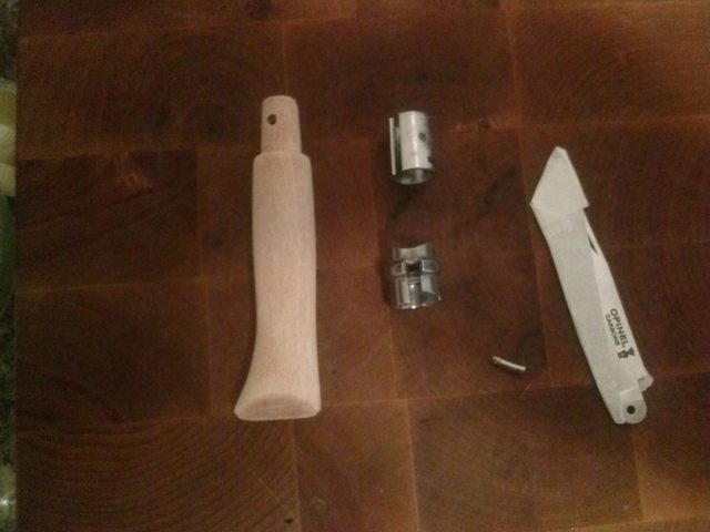

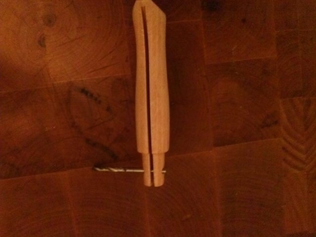

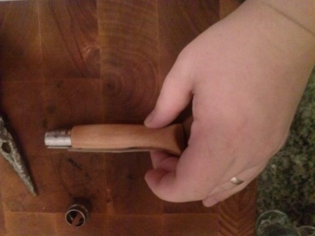

Here it is after taking it apart and sanding it with some 80 grit. Notice the pin size, like many before me i could not get the pin through the blade hole even after hours (literally) of trying. I ended up pushing it half way through and using a dremel cutting wheel to cut off half, and pounded it through the other side.

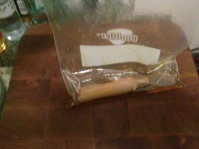

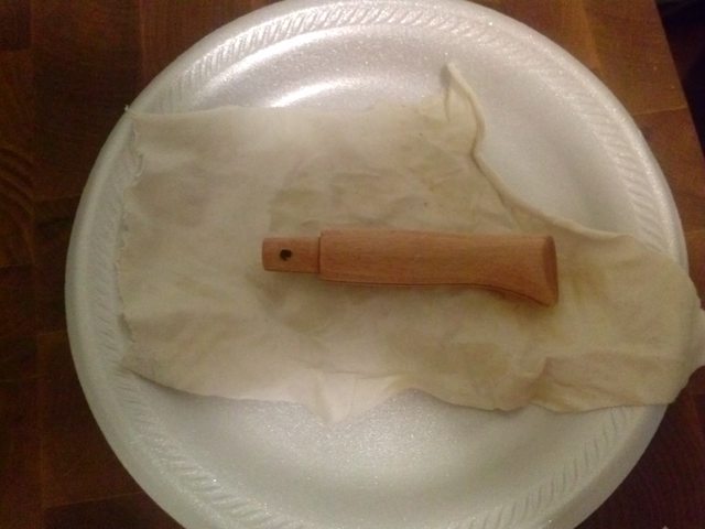

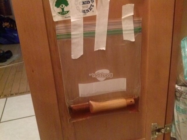

Soak in baggie in BLO.
added more and left it for a couple days

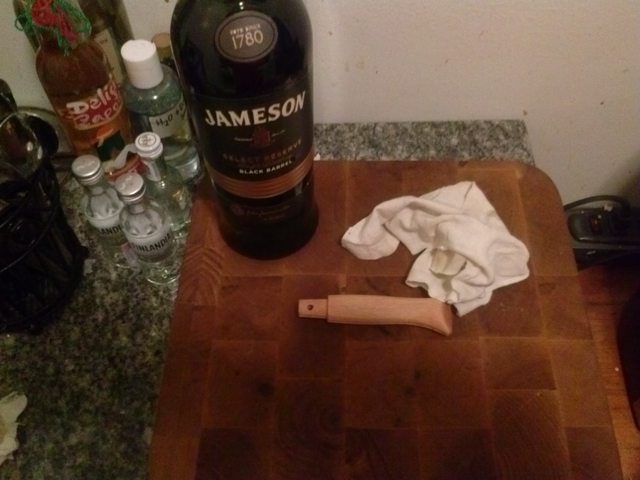

post soak and wipe down
next to some jamey black because men

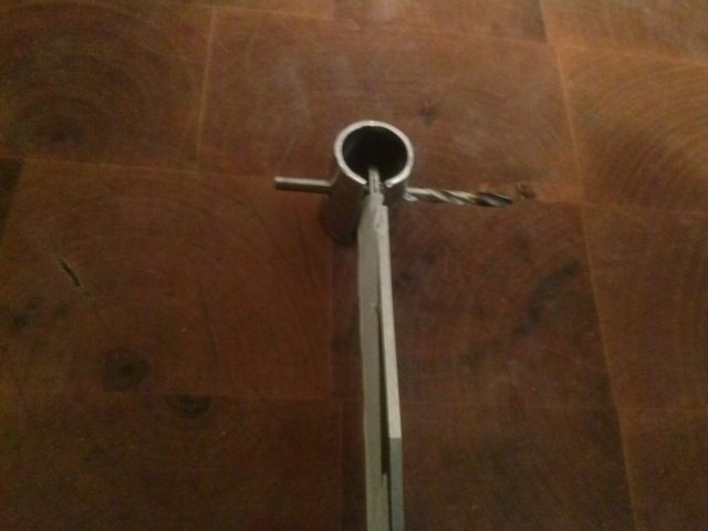

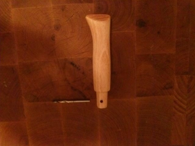

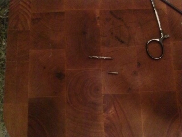

my solution to a broken pin... make one from an old drill bit! I live in a tiny studio apt in chicago while i am back in school, i gotta use what i got!
cut to the right length
it fits!
inner ring check.

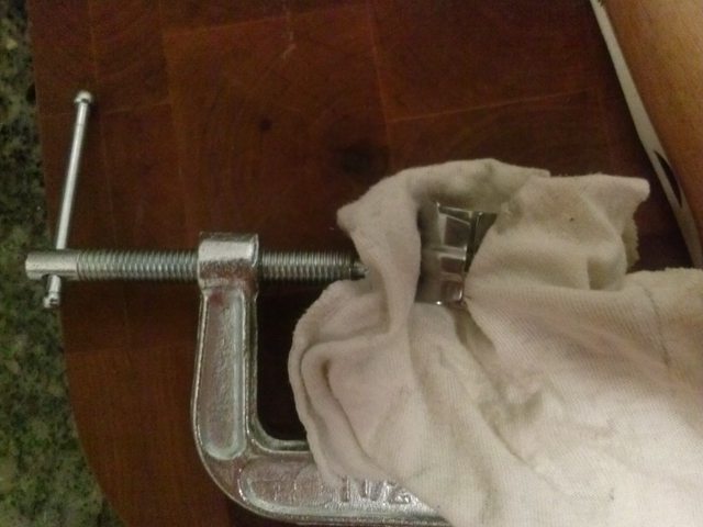

had to use a clamp to tighten the outer ring so it wouldn't come off.

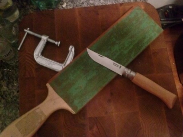

The finished product! it was a fantastic edge out of the box so i am refining it with a touch of bark river green and white compound.

The only problem I have run into is that the pin needed to be a little longer. I failed to realize that the pin keeps the outer ring from slipping off. Until I get something to replace it it should be fine, just a tad bit annoying.

The oil he is using is a drying oil which should seal the knife better. If you soak the whole knife or the joint in a drying oil it will gum it up.
