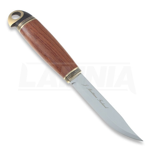

They are mostly known for the very inexpensive fillet knives sold with the Rapala brand name. But they make some beautiful knives as well. I don't have a picture of mine, but here's an image borrowed from the internet of the Bronze Bird knife.
I can't speak for the steel since I've never used it, but it really is attractive. And build quality and finish is on par with Helle or Karesuando.
