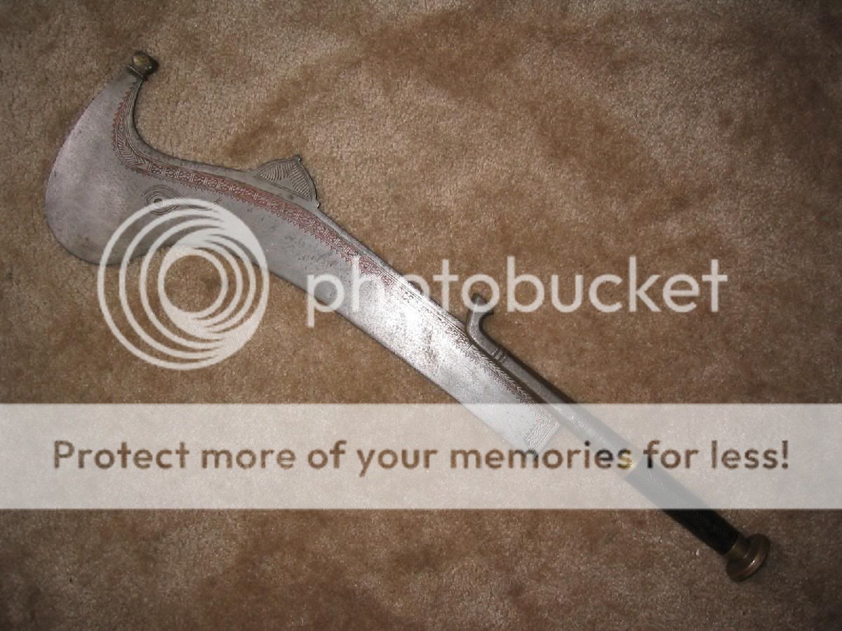

Here's another look at my Ram Dao:
On the term dao, we do know that (1) the Naga ethnolinguistically are part of the Tibeto-Burman branch of the Sino-Tibetan language family, so they are distantly related to the Chinese. As Steve pointed out, Chinese terms have been filtering through southeast Asia for a long time, and there are variants of dao in non-related language groups now as well, eg. Tai, Austroasiatic.
It seems like most people commenting on the subject follow Philip Rawson's proposal, put forward in his Indian Sword, that all incurving blades found in South Asia (including khukuris and ram daos) are derived from the kopis brought there during the Alexandrian campaigns and its successor Indo-Greek kingdoms. But if you look at this terminology as well as the fact that ram daos are localized in the Bengal area and are hilted in a manner more consistent with Naga daos, I kind of feel that it might have gone the other way -- that the ram dao was adapted from aboriginal Tibeto-Burmans and subsequently modified toward Indo-Aryan aesthetics.
Even today, we see that the ram dao is distributed in areas of current or former Tibeto-Burman habitats, from Assam up to Tibet. They aren't, on the other hand, native to anywhere else in India. Combined with the fact that it, like the various Naga daos, is specifically tied to ritual decapitation, I can't help but feel that these "daos" form a tradition largely independent from the rest of South Asia.
At the same time, it also seems incorrect to group Naga daos with the Indochinese tradition which includes Burma. Through ultimately related to the Burmese, the latter have long since acculturated to a SEAsian subsistence and material culture that ties them more closely to the Tai and Austroasiatic people in the area.
I guess the whole point of this rambling is that Naga daos should be considered on their own merits, and not necessarily by how they fit into larger historical/cultural weapons schemas. They're certainly interesting enough on their own to deserve this attention, IMHO. :)
