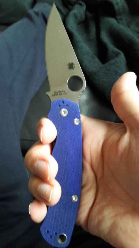

Hi all,
Just received a PM2 Blurple S110V at work today.
I like the blade grind, blade shape, handle, fit and finish, and basically everything about the knife so far.
More detailed review will follow……

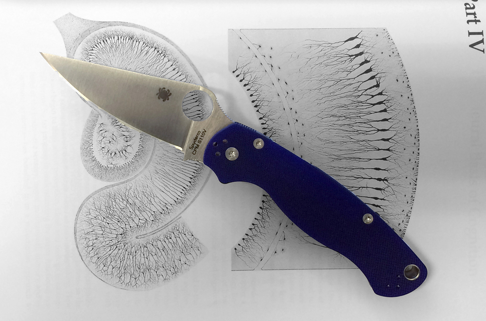

I was a bit skeptical to try this knife because I know I like thin blade-stock thinly-ground slicers (like Boker Plus Exskelibur 1 or Spyderco Stretch 2), and this doesn’t seem to be that kind of a knife at a glance. I have a Manix 2 S110V and barely take it out from a storage box, as it is too thick to be a good slicer.
Anyway I ordered one when the Blurple version became available at my local store. I guess I just wanted to experience the “standard” which are praised constantly by many in this forum, same reason for buying a Sebenza……
Now, holding it in my hand, I really really like this knife.
The fit and finish of mine is superb. I don’t have any complaints at all at the moment. Evenly ground blade, good blade centering, relatively good factory edge, etc.

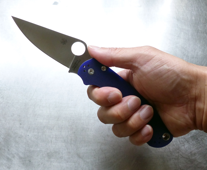

The ergonomics is perfect, as many have said here. It feels like it was custom designed for my medium hand.

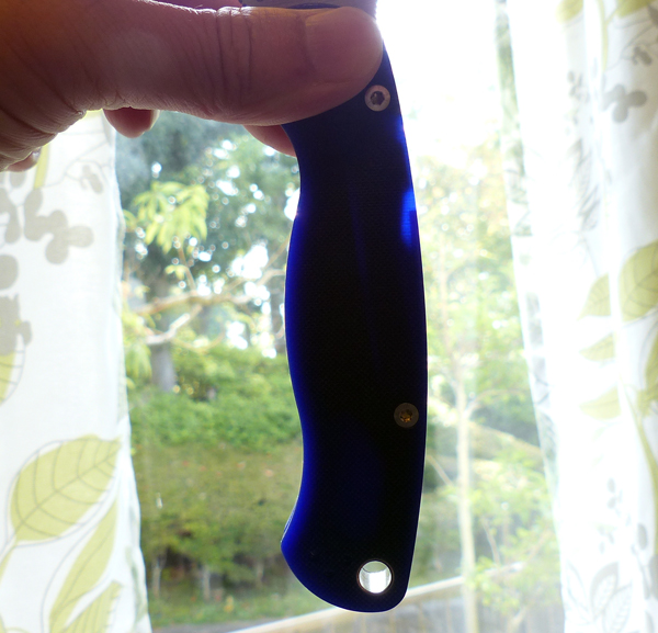

The G10 handle is very grippy and feels extremely solid with the steel skeletons. The slightly transparent Blurple G10 is also pretty and chic without being cheap. Before having it, I was considering to buy Ti scales for it right away. But now I am thinking to just keep the Blurple G10.
The compression lock, or reversed liner lock, is a triumph of designing. Solid, safer than regular liner lock, and easily operable. In terms of operability, I prefer this lock to the ball-bearing lock of Manix 2, as I can easily disengage the lock with one finger and close the blade with a much better control (though I still like the combination of frame lock and front flipper of Exskelibur better for a even better control). When engaged, the blade is rock solid without a play. It is surprising how much confidence that flimsy lock bar gives. I would ditch the knife if it uses that thin lock bar for regular liner lock, but with this ingenious lock design, it seems perfectly sufficient.
The blade. It is a lot thicker (0.14”) than Exskelibur 1 (0.105”) or even Manix 2 (0.125”).
Yet, the grind is somewhat deep. The thickness behind the edge of mine (with the factory edge) is about 0.023”. This makes the blade performs better than that of Manix 2 (with the edge thickness 0.03” at 15 DPS) and close to the level of Stretch 2. The semi-Wharncliffe blade shape also makes it a good cutting tool, particularly at a kitchen.
*Note that the blade shape was modeled where the blade width was about 1’ for each model, but not at the thickest part of the blade.
In fact, PM2 cuts a tomato well and clean. The thin blade near the tip also provides very fine cutting.
To sum up, my first overall impression is that it is a very very capable knife. If I am forced to rely on only one knife for life, I would choose this one (or Southard Tolk) for its versatile cutting ability, sharp tip, solid feel, good ergonomics, and the premium stainless steel, even over Sebenza or Umnumzaan.
I will sharpen it and use it to see how it holds up.

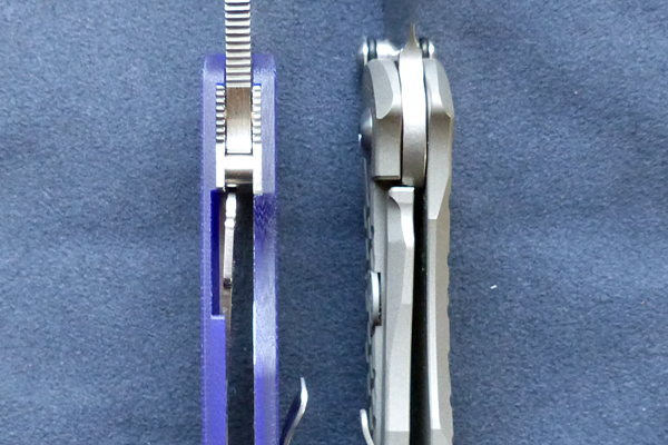

Disassembled.
The busing pivot is nice.
But I think the construction is quite different from that of Sebenza in that the bushing pushes the washers in PM2, whereas Sebenza's bushing doesn't.

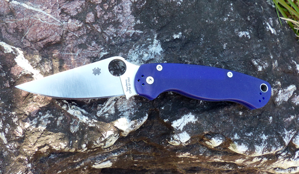

I have reprofiled my PM2 S110V to about 15 DPS. I think the factory angle was somewhere at 16 and 18 degree. It took me about 30 min to reprofile with Edge Pro Apex.
I spent most of the time with 120 grit silicone carbide stone (Edge Pro) and stepped up to 240 followed by 400 silicone carbide stones (Congress Tool’s Moldmaster). Then, the blade was stropped on a horse leather sheet loaded with Pikal (aluminum oxide compound, presumably comparable to the white compound). The result was very aggressive edge capable of cut soft tissue paper clean.
I have cut up a few cardboard boxes and found that the edge is still very aggressive. I will see how it holds up over time.

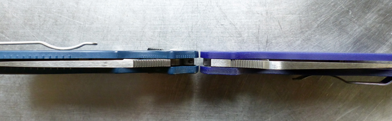

Just to add that I am really happy. Same excellent fit and finish as the jade g10 m4 version, though I feel like the blurple looks much better, but that depends on the person.
