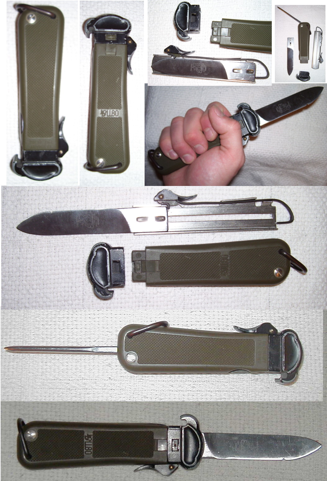

If you mean the WW2 German knives then google: fallschirmjägermesser and fallschirmjäger messer
(fallschirm=parachute jager=trooper(or hunter) messer=knife)
