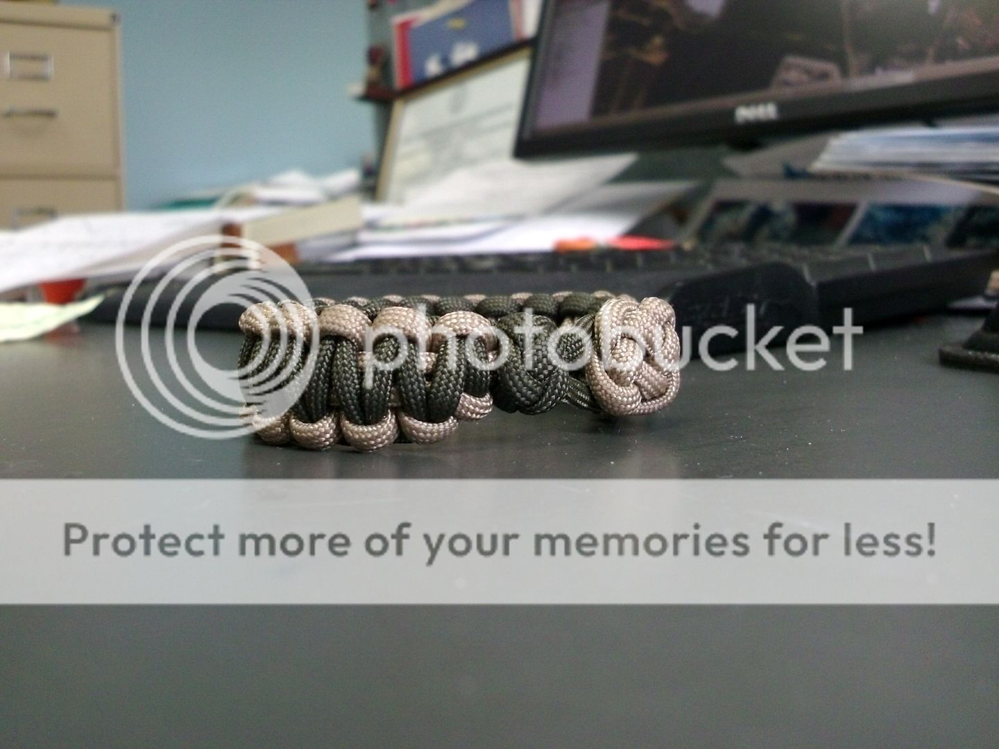

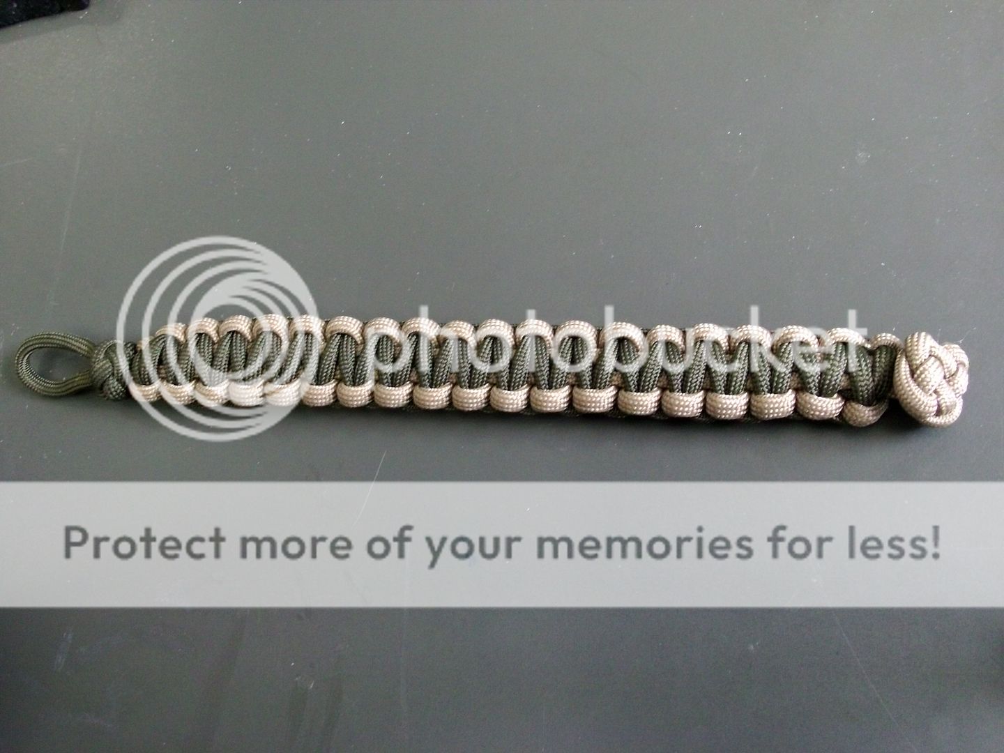

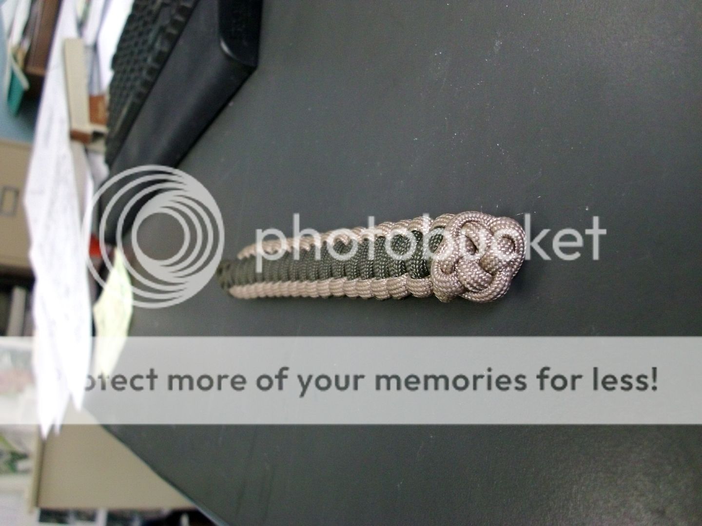

...made this for my friend Sgt. Mac, uses 12' +/- and no buckles (6' per color). I pre-shrink the cord on bracelets, you should too! I kept three cords on the inside to give it a little girth, this is a man's bracelet after all. standard cobra stitch. did one like it before, but used only two strands inside. it was for my son who is 8.
