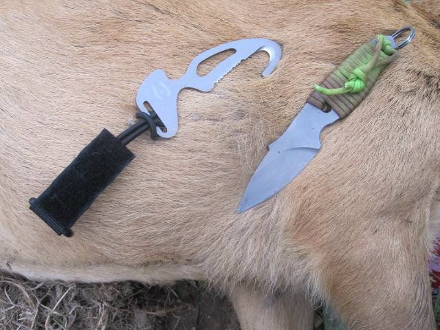

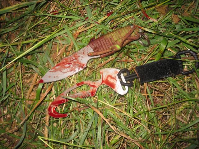

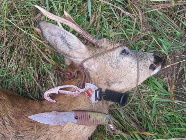

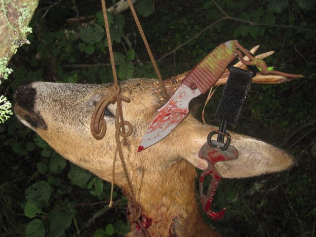

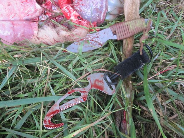

I was infatuated with paracord handles for a while.
But after using a paracord wrapped knife handle for hard use, you quickly find out, that cord is very uncomfortable - at least to the unprotected hand. A glued paracord handle is even worse.
Further more blood and guts in the cord is an outright Health hazard. This can be alleviated by unwrapping the cord and washing it after each outing, where the cord gets small bits of organic matter in between the different strands of the cord.
That quickly gets annoying (to have to unwrap, wash and re-wrap the handle after each use).
Personally, Im fed up with paracord handles and prefer not to have them on hard use knives.
Just say NO to paracord wrapped handles on hard-use knives.
I guess, that some people find it cool to have paracord around the knife handle and think, theyll use it in an emergency.
But how many really have a need for that.
Id go out on a limb and claim, that if you have to resort to unwrapping your cord knife handle, you came ill prepared.
On outings, I carry lengths of braided paracord for various uses - when gutting a deer or dragging out a deer from undergrowth or what ever.
Paracord is very useful, but I dont see a need to wrap my knife handles with it - at least in regards to hard-use knives.
As can be seen below - paracord can get messy and its not not very hygenic
