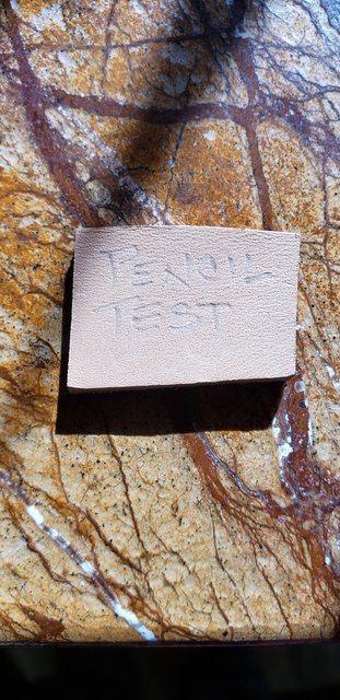

I received my pencil and eraser! On veg. tan it shows fairly well and the eraser works like a charm. I pressed very lightly on the pencil but there was enough for these old eyes to see the marks. I'll post the pictures as soon as I figure out this thing.
Water soluble graphite is fascinating! I found it a couple years ago in an art pack. Mine are solid woodless pencils, I'm glad to see these smaller lead wood pencils! Fantastic thread!
As promised, though it took a while.
Before
And after
Thanks for the follow-up. I don't press anywhere near hard enough with a pencil to leave an impression, so I'm really tickled to see that even then, the eraser was still able to remove the mark. But I will also say the new pencil doesn't leave a mark anywhere nearly as dark as the one I have.

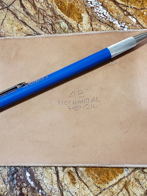

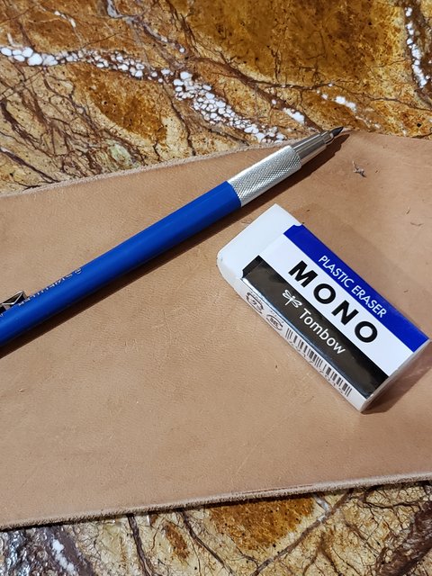

Here we go. I ordered a mechanical pencil and a pack of 4B graphite leads (these are 2mm leads and I couldn't find 6B which I wanted to try) All in all about $23 with amazon prime. I really like it, the lines are very clear and dark and the eraser performs flawlessly.
And after
