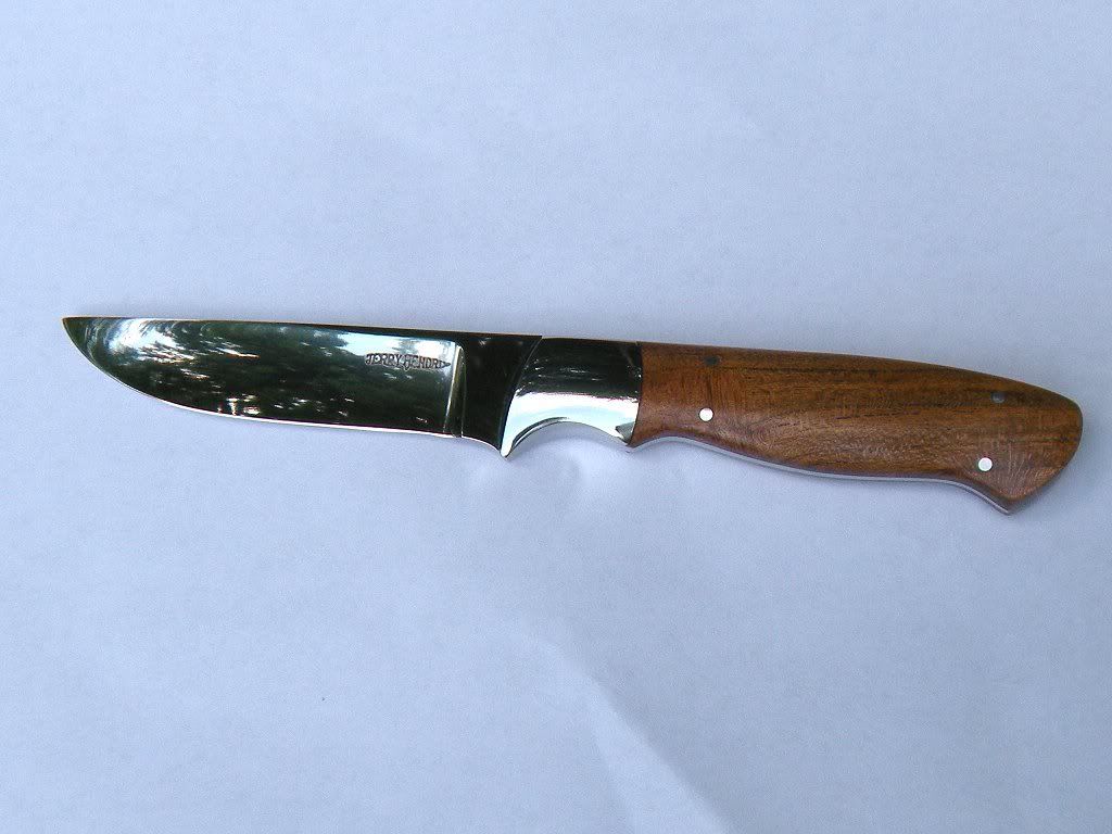

Heres a pic of some persimmons from Jay Fisher's site. Heres the description he gave...
A small amount of this wood was given to me by a former knifemaker. He called it Chinese Beeswing Rosewood. It certainly has a nice, small wavy design in the grain. Makes a great knife handle, with a noticeable, bold figure and lines. After research I found that Persimmon wood panels were used in early Chinese, Korean, and Japanese reproduction furniture, so that is probably why he called it Chinese Beeswing Rosewood. In sizeable amounts, the wood is rare and valuable, since the heartwood core of the tree is very small. It's medium brown, moderately dense, and has a unique wavy figure in the grain. It has a sharp, peppery smell when cut. It polishes moderately well. It's been widely used for golf club woods, tough textile shuttles, turnery, and striking tool handles. It' is highly resistant to impact.

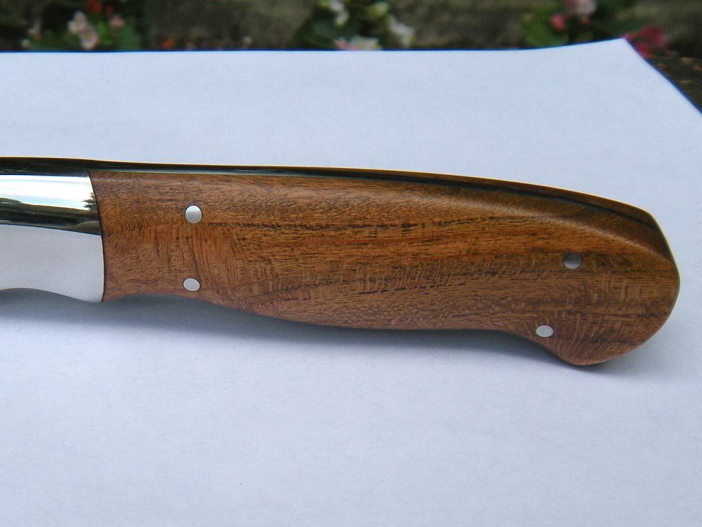

I picked this one up from Jerry at a Blade show in the past and I'm sure he told me that this is a Persimmon wood handle. He also let me know how hard this wood is to work with.
