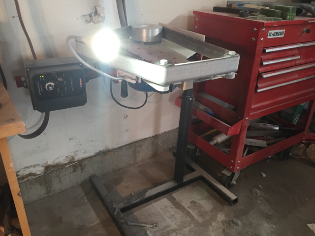

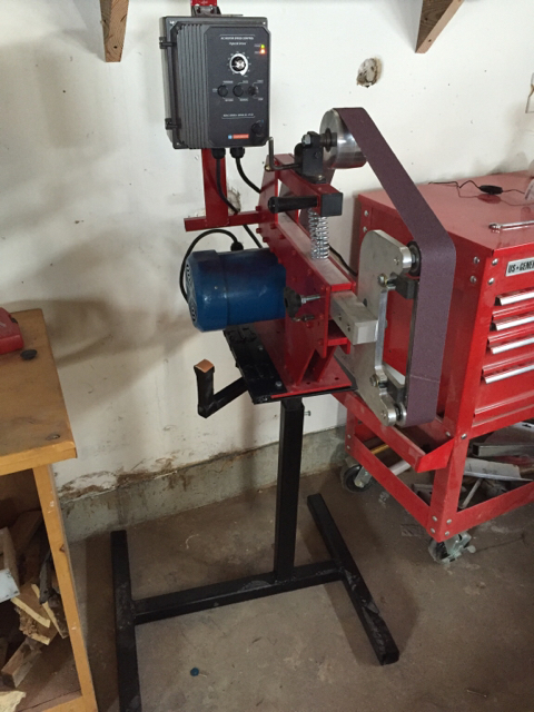

I would recommend putting it on a tilting table, it's super useful.

Trocky Awesome setup... Did you make the table?
Exactly why I am looking at the Pheer it is easy to tip sideways. Had a KMG for 16yrs was still going strong when I cleaned out the shop.
But there were many many times I had to "grind blind" and the tilt will eliminate that
I did build the table. I almost didn't incorporate the horizontal option but I am super glad did. It is so nice for a lot of things. I would definitely recommend making the height adjustable as well. If I were to build another one, I would probably make the tilting mechanism more similar to what you see on the tw-90, just in the table instead.
