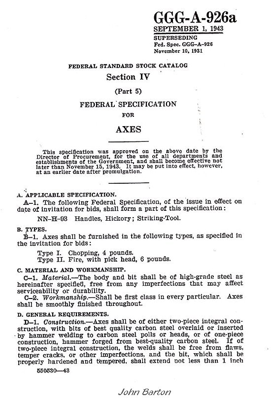

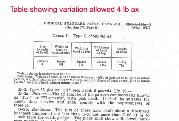

While waiting for Double Ott to show up with some more information, a previous post from him said the military axe specs were:
AXE: Single bit, 4 lb head weight, 4.750 inch cutting head, 31.00 inch handle length, Federal Spec GGG-A-926, type 1, class 1, design A.
Many of these axes were carried in Pioneer Racks on military vehicles like pictured. The rack also carried a shovel and pick axe. The pick axe was carried with the handle and the head separate.
The military specs for them was:

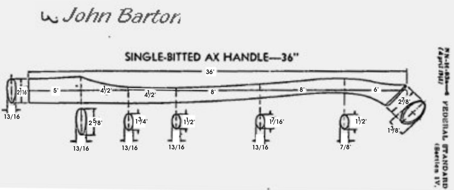

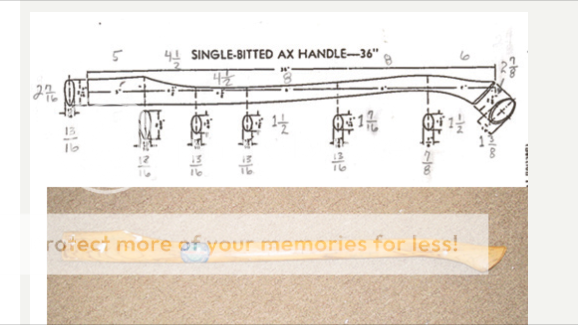

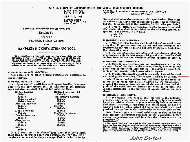

Found some information compiled by a guy named John Barton at this site:
http://jeepdraw.com/John_Barton2-AXES.html
Source: John Barton, jeepdraw.com
Good work, Steve. I wish there was a higher res. image available with the handle dimensions legible.
Having purchased about 30 of these axes for a workshop I can verify that 4# Dayton heads on 36" handles were standard. Made by everyone from True Temper, Council, Collins, and Woodings-Verona. Usually painted entirely from head to foot in OD green, desert tan, or black. I actually just found about 9 old handles from the lot I bought a couple years ago.
