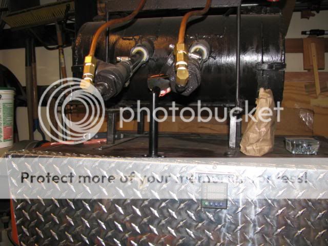

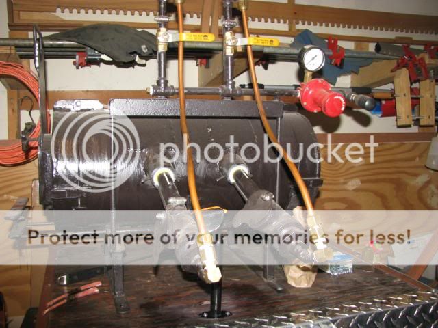

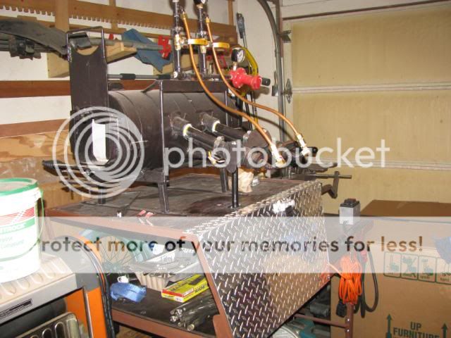

My forge is an ever evolving project at the present. Here is a photo taken last year of it on the grinder/forge cart I have made for it to set on to give me the option of rolling it around for lack of space and being able to get outdoors to vent!
This is present day.
If you look closely you can see where the PID controller is sitting, mounted in the aluminum diamond plate below the forge.
Eventual the PID will be used to read the K-type thermocouple I have it hooked to now and control the gas solenoids that will run the propane through the forge.
For the present this is what I want to do! I want to use the PID to monitor the temp from the K-type thermocouple and sit off an alarm 50*F before it reaches maximum or minimum temp for working 1080 steel to forge temp.
In other words the maximum working temp is 2150*F, so I want to sit off the alarm at 2100*F to warn me it is approaching to top limit.
I also want to set up for minimum temp which is 1500*F, so I want it too set off an alarm at 1650*F to warn me it is approaching the bottom of good working temp.
I will manually have to control the temp by the valves to keep it within the proper working temps!
