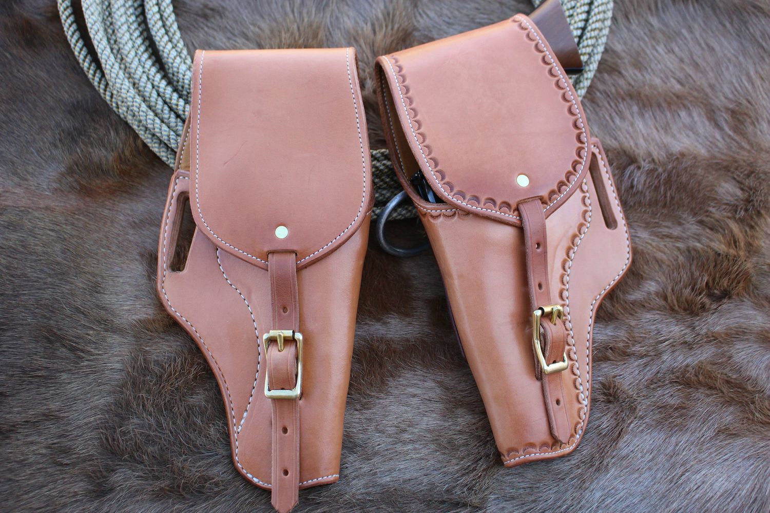

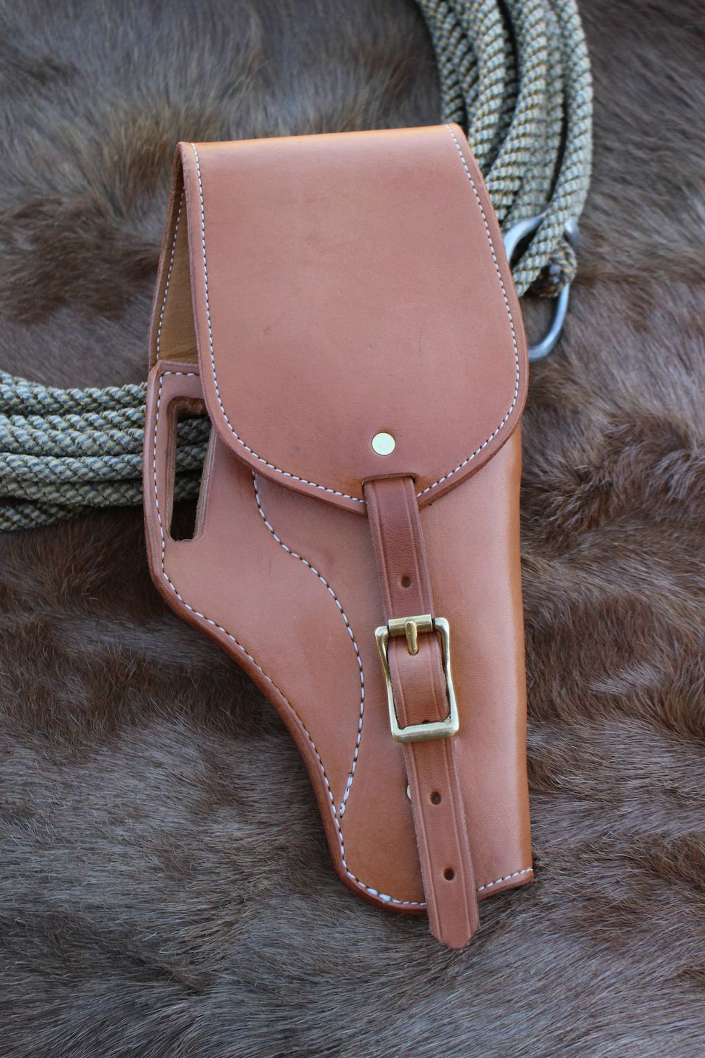

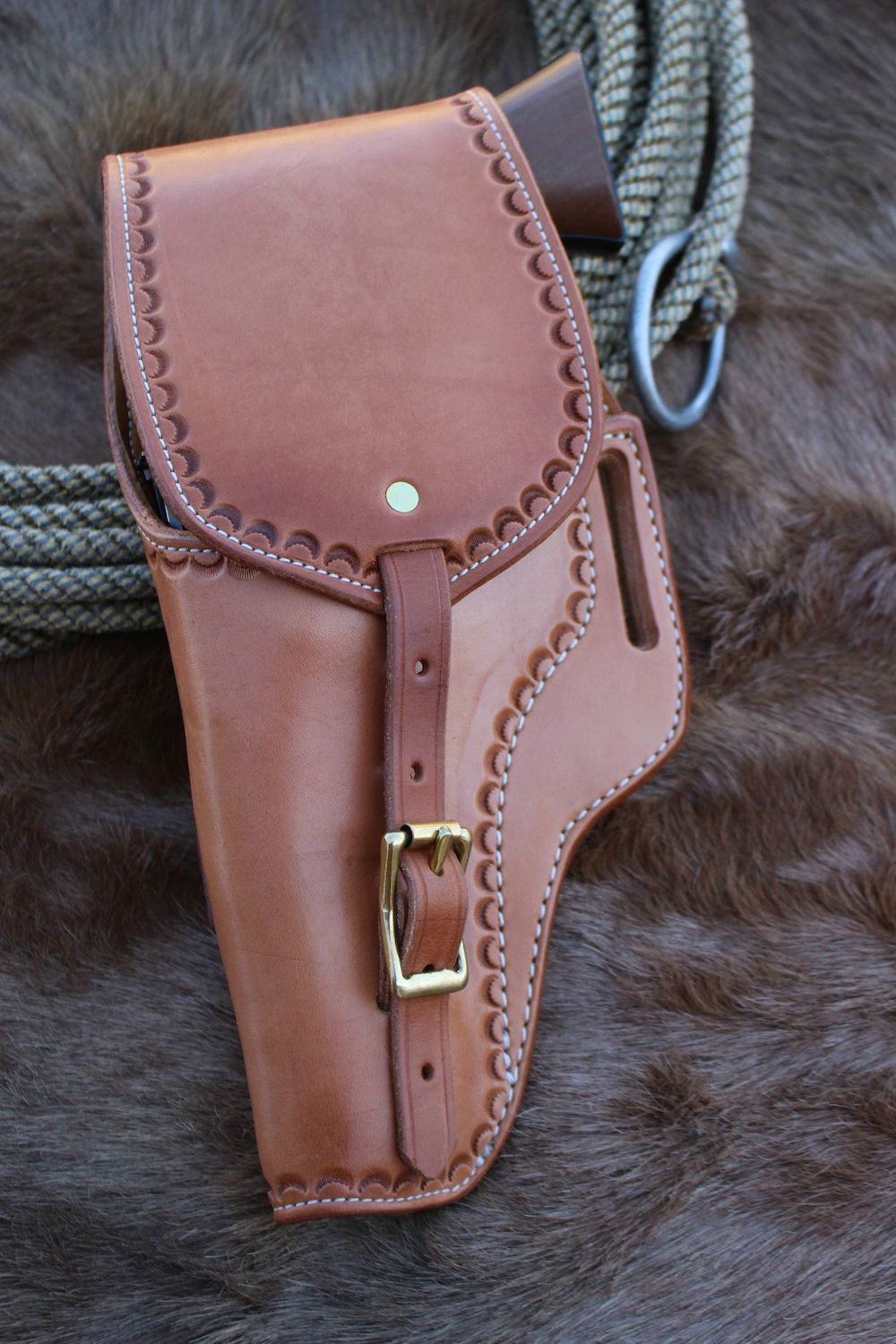

Thought I would show you guys this oddball. This is my second holster, a friend wanted a classic safari style flap holster with a flap that could be rolled to the side exposing a modern self retaining speed holster. The inner is molded horse hide, the rest is 9oz Herman Oak. I pretty much had to invent it as I went, lots of trial and error. The final flap has a reinforced pivot and a secondary strap to hold it up. After unsnapping you roll it to the side and there is a hidden snap inside to re-secure it. where the flap is cutout around the back strap there is an extra layer of horse hide. and the belt mount on the back is open on the grip end to allow either a 105deg cross draw or a straight up and down right hand draw. There is also a matching belt and knife sheath that I didn't get pics of. Finally, this is the first carving I have tried, still have a long way to go. hope you guys like it.

rtmindvery nice work. Nice job on the carving on the flap. Interesting design.
That is a sweet holster and revolver!!

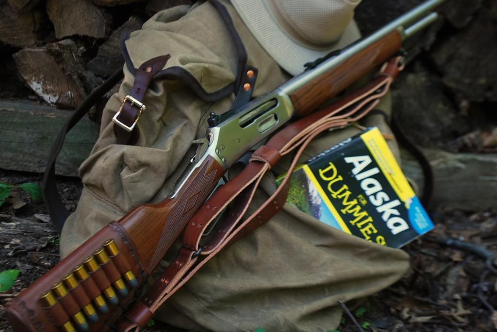

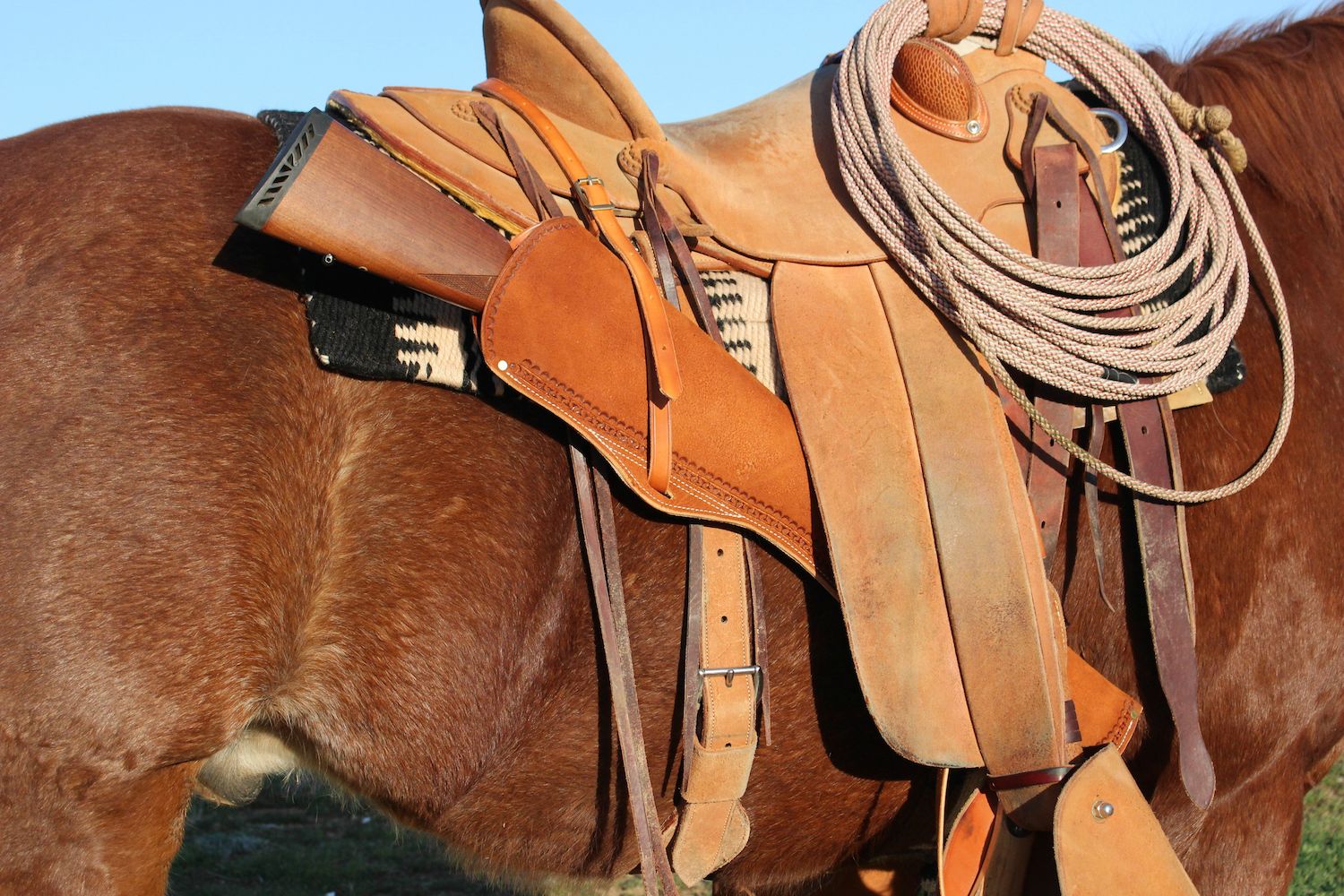

Dave, is that a 'guide gun' peeking out from your nice scabbard? That 100% rough out rig is fantastic as well. I'm a fan of all things Marlin and own more than a couple. My '95GS is the 'go to' though.

Thanks Horsewright, Larson and WEB2. This has been my most ambitious project to date. Was fun trying to work out the details, and my buddy is thrilled, which makes it even better. Rtmind

Yeah Eagle, Guide Gun in .45-70. Fixing fence in the way back up high places where the BIG hogs, BIG bears and Big kitties live:
Nichole has my back with the Marlin while I'm down fixing fence.
No not really, I was adjusting my saddle after a steep climb and she was just holding the rifle for me but the other is a better story!

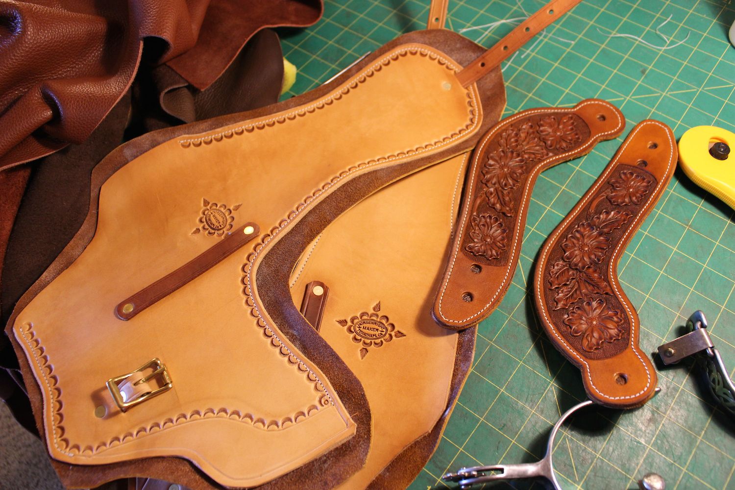

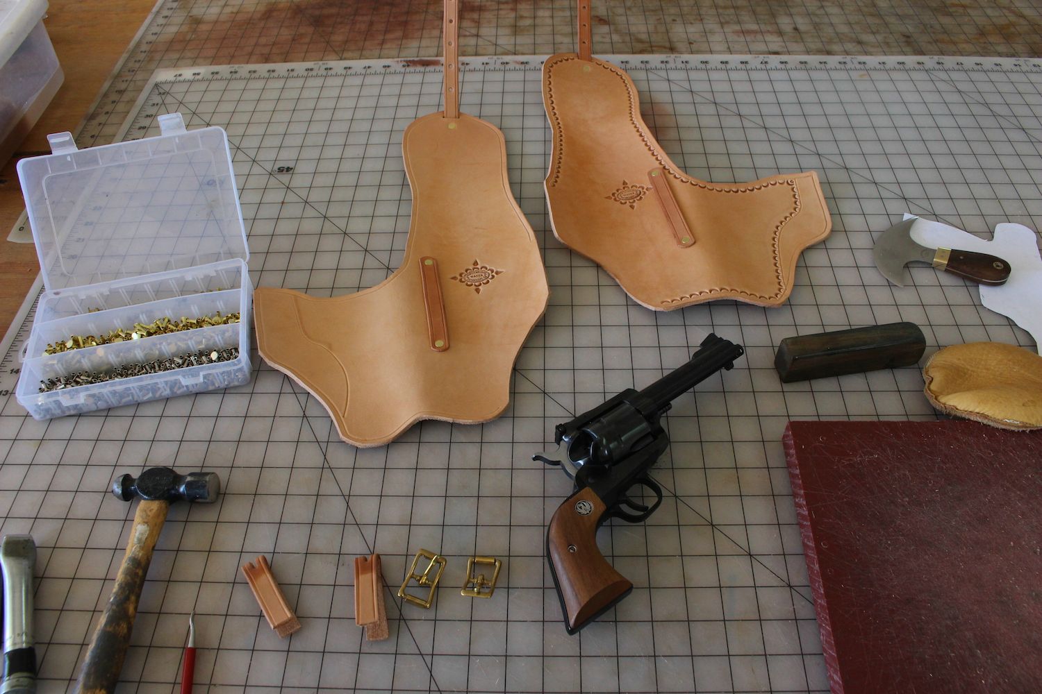

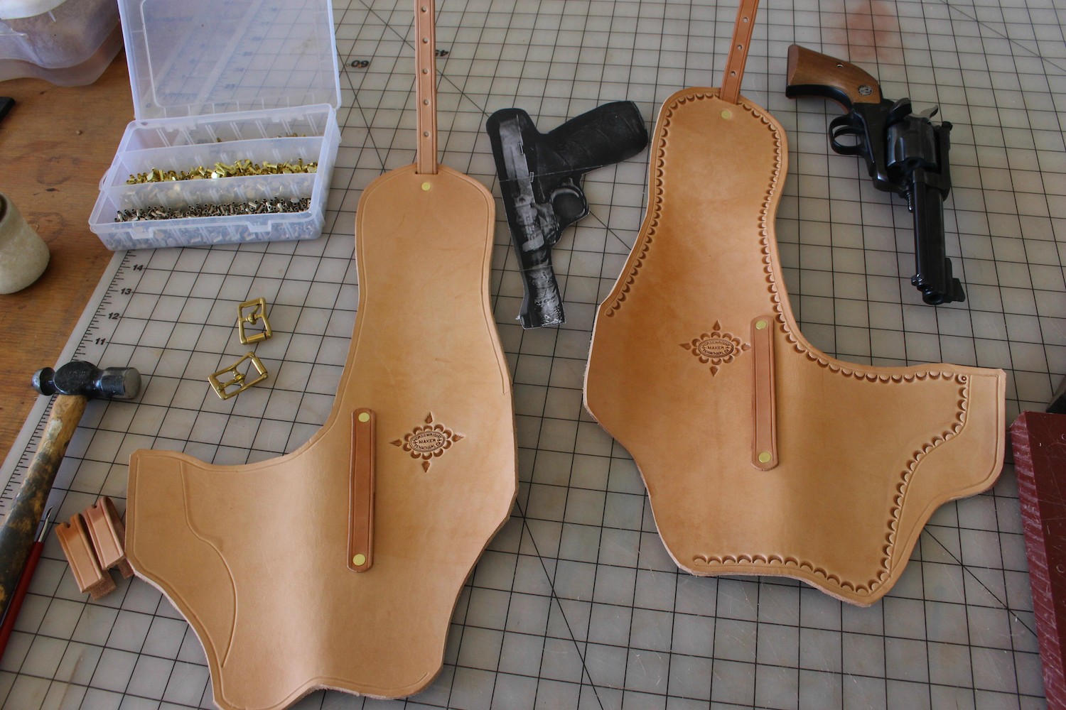

Here's a couple I'm working on right now.
Anthony was here Fri and I'd been saving these to do while he was here. However, we had some unexpected friends/customers from England stop by and so we just didn't get to do everything we wanted too. I didn't start these until after Anthony had to leave.
I cut them out first and adjust the pattern to fit the gun requested. Do any tooling requested then make the straps and attach the hardware, basically get them ready to have the lining attached. Buckles to put on yet.

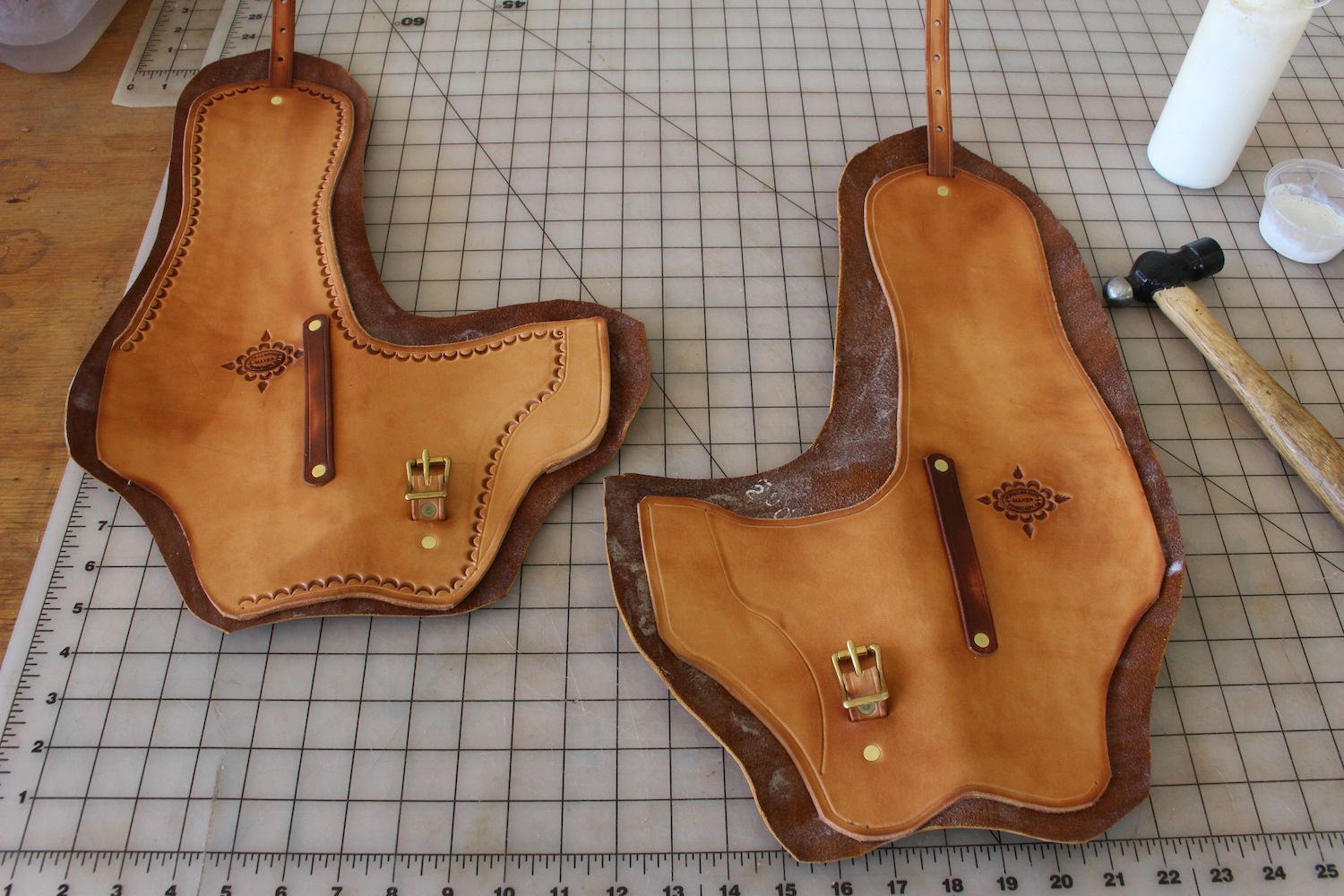

Buckles on and then a couple of coats of warm neatsfoot oil. Ready to cut and glue in the lining.
Marking the linig. One of these holsters is a lefty, ya got to remember such things. I've found putting the object face down and then drawing around the linig helps keep leftys with leftys and righties with righties. That way I don't cut a left hand lining for a right hand holster etc. Have done.

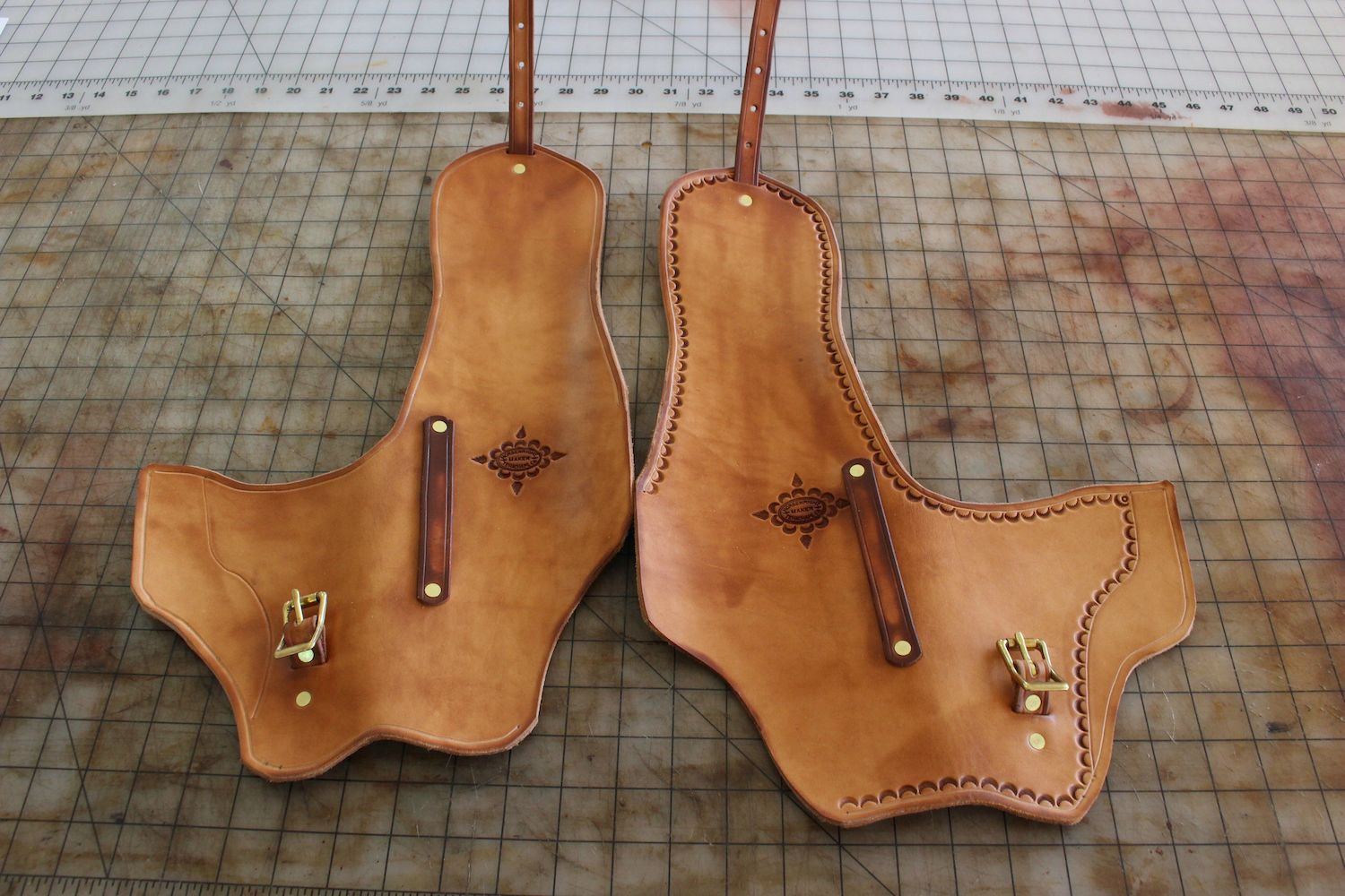

Linig glued in looks like I got em right.
Got to rember to work your wrinkles out when lining. This holster is a little tough cause you have the bend of the holster itself and then the other bend of the flap coming down.
Lining sewn in now. Nichole was sewing in the lining on these spur straps she was making for herself so I had her sew the linings on the holsters too. Now just trim the lining, edge the edges you can't do later, (basically whats stitched now), fold em in half and stitch. Do that common edge, apply finish and they are done.

All done with the two above.
The lefty for a local guy with his .357 Blackhawk:
This one is for a Buckmark:
