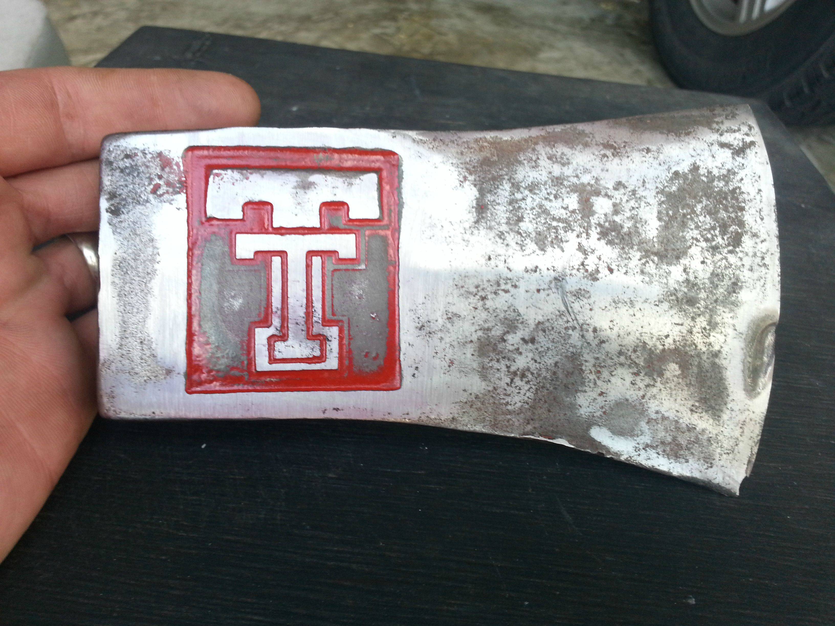

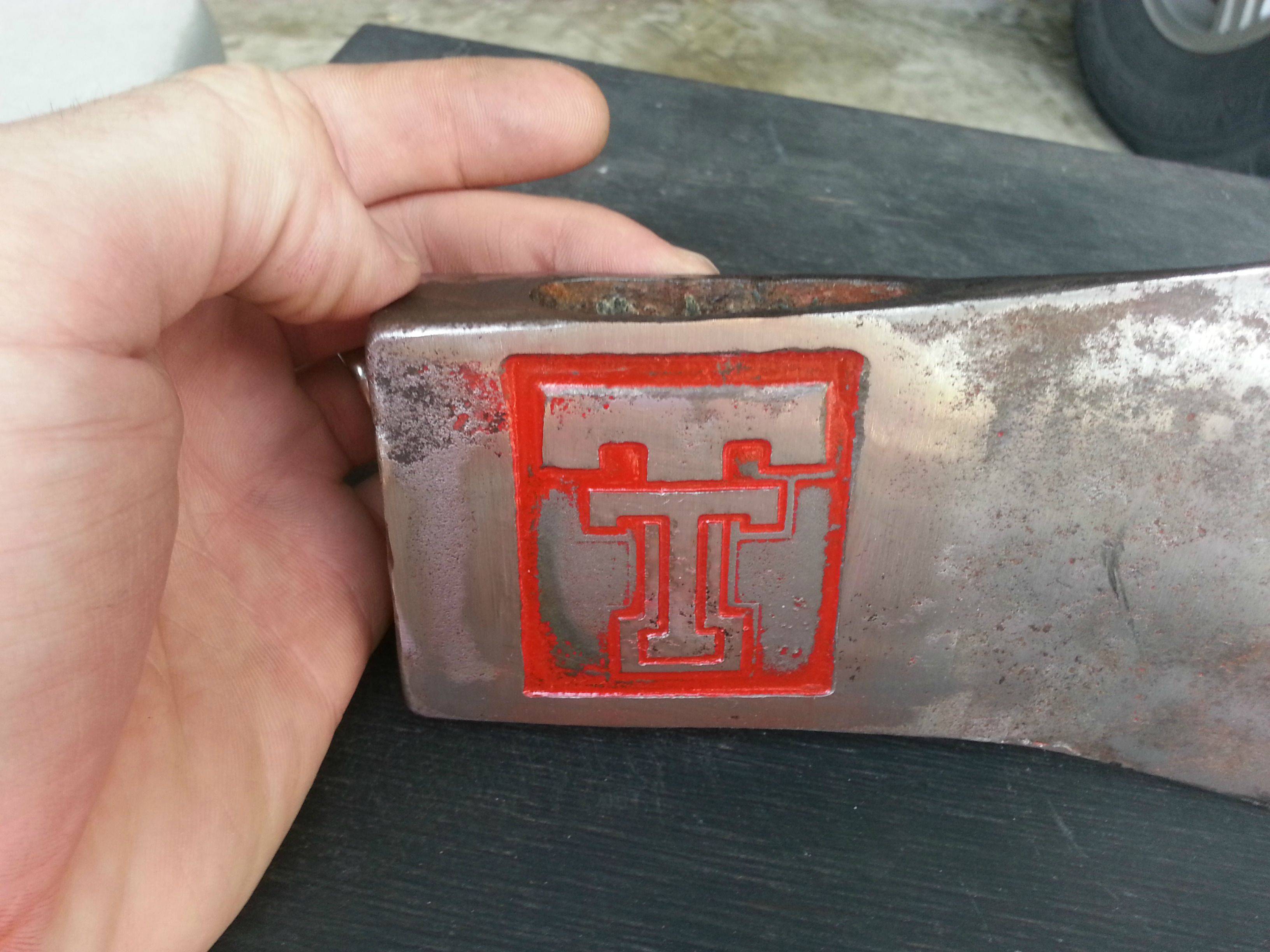

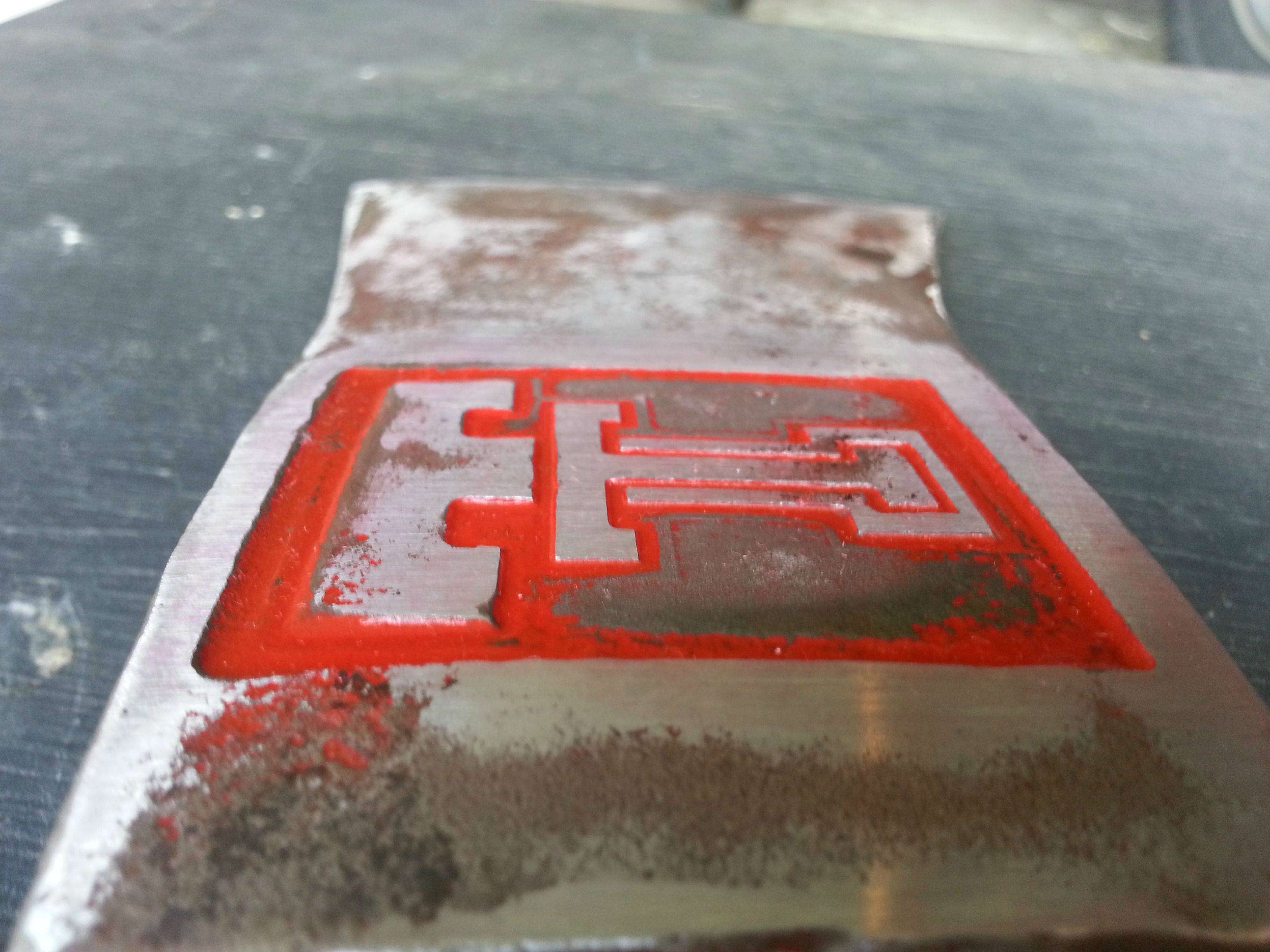

This is the first axe head I've tried to electro etch. Learned some lessons (one of the is cover the other metal better as you can tell from the divot out of the bit). It's a true temper A9 boy's axe size.
I think with a little practice I'll be able to make it look pretty dang good. Questions, comments, or tips welcome!

Ok so if you don't want to read the link, I'll give you the reader's digest version.
1. I used a vinyl sticker to cover the TT to prevent the etching from effecting the TT itself. Then I boxed out the TT with electrical tape and covered the ret of the axe head in electrical tape with wires connected to one side of the axe head and fully sealed with tape. (The tape didn't seal well right at the bit so it was not protected from the etching process)
2. Put water in a plastic (or glass would work) container and put in salt until it stops devolving.
3. Place a piece of "sacrificial" metal in the water with a little piece hanging out of the water (to connect to later)
4. Put the axe head in the water with the part you want to etch facing up, and the wire out to the side of the container (make sure this wire is fully sealed from the salt water solution with tape or other insulation.
5. Using a car battery charger, connect the positive (+) terminal to the axe. Connect the negative (-) terminal to the sacrificial piece (I used a piece of metal that was used to support my old microwave... Anything steel works)
6. Plug in the battery charger and I set it on high (6amps and 12 volts) for about 6 hours. I was checking on it too much and messed up a little piece of the sticker trying to clean all of the gunk off the axe while it was etching, so if you close in person you can tell it's a little messed up. While it's etching a nasty gunk will build up on the part that's etching and make it look like it's massing everything up. Next time I'll set it and forget it so I don't screw it up.
Bubbles will come off both pieces of metal, my sacrificial piece bubbled MUCH more than the axe head, which was contrary to the instructibles notes, but it was working right.
The salt water solution will get NASTY brown black stuff on it. The bubbles are a mix of Hydrogen and Oxygen so do this somewhere well ventilated so you don't die and blow up your house. That would suck.

I read the whole post in #6. I think it's an outstanding way to customize axes or any metal project. The author of the post was working with some fairly uniform metal, not like axe heads which have very few flat surfaces. I was just trying to think of a good way to mask off the parts you don't want etched. It sounds really difficult to mask a clip. I just thought a little damage on the poll was easier to correct. A brazed or soldered connection would be easy to remove,after,etching.
I'm amazed you were able to mask your axe head as well as you did. Just thinking things through before I try it myself.
I think you did an awesome job.
