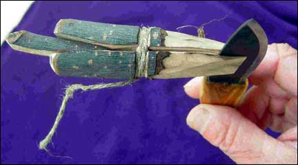

There are all kinds of free devices you can make... some don't even require making
leaning your sharpening stone against a wall or book to make a bench stone sharmaker and just slice down the stone and pivot for tip
make one from paper, fold plastic V, mini clothes pin , gluesticks, wood ...
Midrange-Knife-Sharpening-Jig
Simple sharpening jig - stefanwolf88
How to Sharpen a Knife with Paul Sellers
