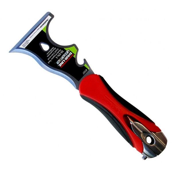

Yeah, I'm a painter too. I use a 5 in 1 and (currently) a victorinox camper.
I do very little residential... More commercial and industrial, and the only thing these two tools will get the job done.
I even used the saw once outside to cut some branches that were ruining my freshly painted Windows.
Sebenza
'Nuff said :D
Seriously though, the jobs you are listing are not what I would recommend any knife for. The painters tools shown above are going to probably serve you best AND you can keep the knife you already have and like with a better edge preserved for cutting tasks;)

We definitely use 5-in-1 tools, don't worry. The problem is that they get used so much that they tend to dull even faster than my knife, and a lot of the time there are just some jobs that are easier and quicker to do with a knife than a 5-in-1, like cutting small branches and making lunch. Plus a pocket knife is just so much easier and more convenient to carry up high on ladders and roofs if you catch some quick work that was missed during prep.

Do you not wear painter's pants? The white dickies ones? They have a pocket purely dedicated to holding a 5 in 1.
