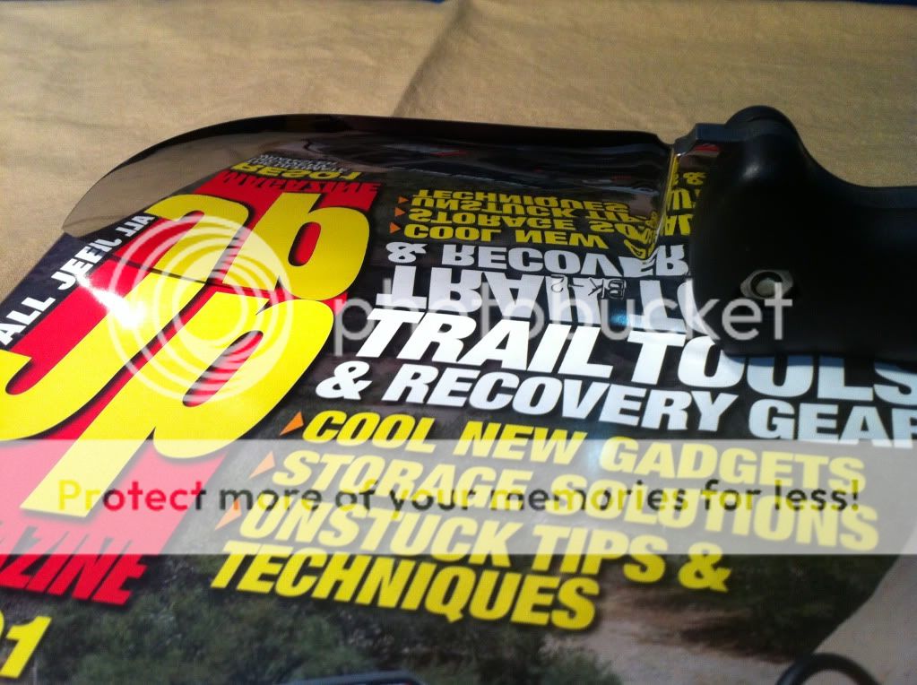

did somebody say polished becker? I thought this thread needed some pics.... :D
