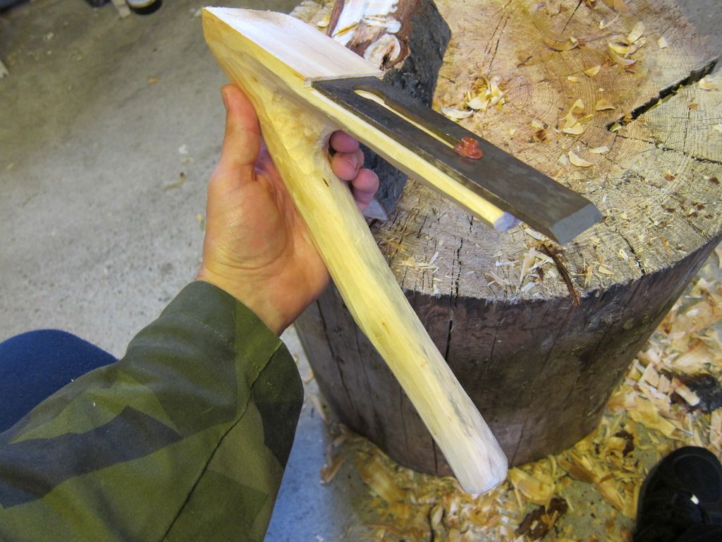

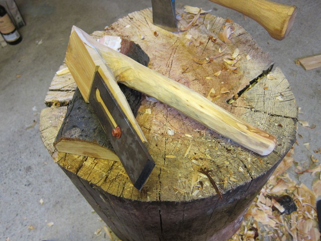

I usually buy myself a nice plane when it comes my way, but some planes are too bad to even try to restore - I have ended up with a couple of good steel plane blades, which I thought could make a nice little adze or something.
Went out yesterday to find myself a good handle for my project - the handle isn't ideal for this application, because it's a little too 'closed', which makes it uncomfortable to use, but it's workable.
Didn't cost anything and it was a fun project.
Hey,good job,mate.I'd try turning it bevel down,it'll open the configuration(though for some stuff you may have to countersink that screw).
Thank you Jake, that's some good advice. I harvested three potential handles yesterday, might make a new one and see how that works with bevel down. Might work better with a new handle with a little more curvature in the handle. I got to say that the screw isn't pleasing to the eye lol might have to do something else about that

I don't remember if using a bolt to attach the head was intended to allow easier sharpening or it was just some person's observation. Also, not sure how the original bit was shaped, but mine followed me home hollow ground. Right or wrong that is how I start with chisels and plane irons if they are at a point where they need it. Let me know if you want any details from my handle.
Bob
I would refer to them as bevel up in use since the bevel is on the opposite side of the work, but YMMV. Also, because the bevel faces the handle, a detachable head does give a lot more clearance if you need/want to establish the bevel on a grinder.
Perhaps a carriage bolt would do the trick.

That would probably be better, and a bit more pleasing to the eye.
I got a whole box of old carriage bolts but I have not found a single nut that fits. The struggle for metric standards continues... lol.
I could buy a new bolt and nut that fits, but then again, I'm a poor man ;-)

I don't intend to bend it, rather grind it to a half-round profile when viewed as it would lay flat on a table. So it would look like a shovel with no curvature. Just to hog out a bowl from green wood.
Ah,i see...Well,i hesitate to say how well it may work on bowl-shape...
I Theory it's possible,and the chairmakers did have a type of a plane used for chair seats that functioned on similar principle...
The big question that remains to be asked: how well is it working?
It's actually working as it should. It removes wood, it took me a while to get the hang of it but now that I do, it's pretty amazing how functional a simple homemade tool can be.
