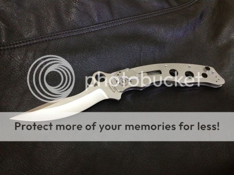

I was also on the fence about this one, but I jumped on it anyway. Absolutely no regrets here.
This is a beautiful knife, equal parts intimidating and awe-inspiring. I don't have large hands, but despite the Szabo's beastly size, it still feels great in my hand. I happen to love large folders (the Resilience was my first Spyderco), and as soon as I picked up this tank of a knife, I knew it was going to be one of my favorites.

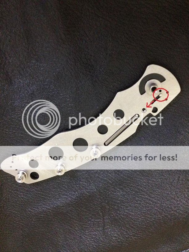

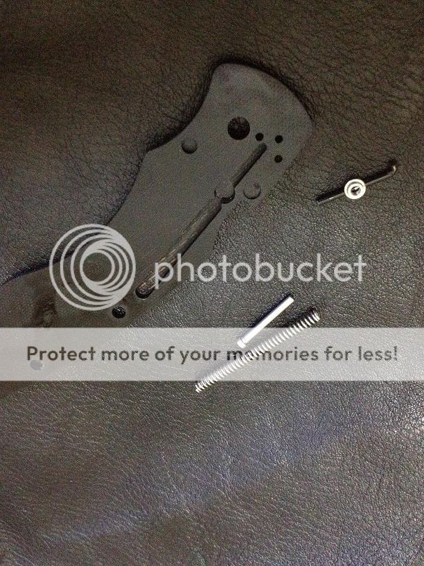

There is no detent in the Laci Szabo folder. I've disassembled the knife completely, removed the springs and then reassembled it. Without the spring, the blade do not stay in closed position. It took me quite awhile to figure out how to put everything back together again.
This is the toughest knife i've ever reassembled. I thought that the Navaja was bad, but this is much worse. The spring is really pita...
Here are some pictures of the internal parts of the knife.
*edit: There's one more picture that's not showing...
Thank you for posting pictures of the internals! I know you said that there is one more pictures that isn't showing up. Do you have any pictures of how the spring interfaces with the blade.
Now the last picture is showing up. The back side of the scale looks cool. Thanks again for the pictures.
I can't do that because there's a thin circular plate that is attached to the blade tang. This plate will spring out if i took the blade out of the pivot because it's constantly under pressure from the compressed piston spring.
When the blade is opened, this plate pushes the small little black bar which compresses the spring fully. Here's a picture to illustrate it.
Thank you. This is one complicated mechanism. I am still trying to wrap my mind around it. I am not one to disassemble knives, but I will definitely not attempt this one.
