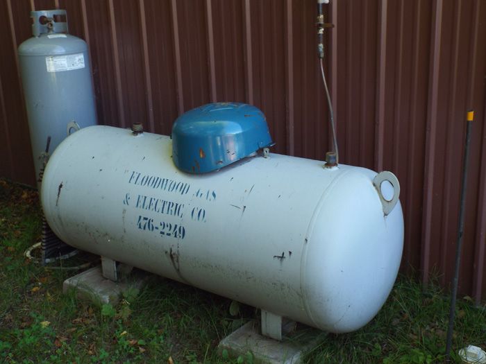

I had two 100 # tanks, and about six 20#ers. I got rid of one of the 100# tanks and just change to a 20# tank when needed. I set the big tank to the side to take it down to the propane filler next trip that way.
You need a 100# tank to do any long duration running of the forge , as a 20# tank will freeze up if run longer than 30-40 minutes at any higher rate of flow. Damascus welding with the burner running wide open will freeze up a small tank in 15 minutes.

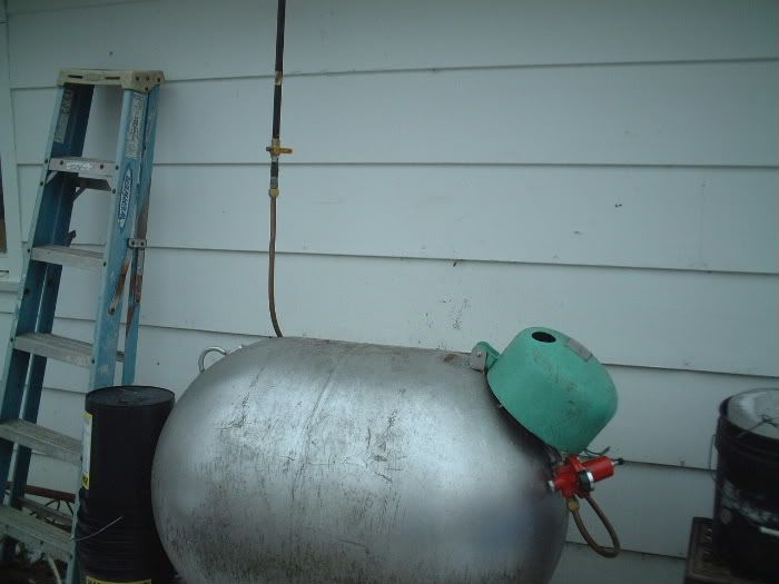

I used to freeze up my 100 pounders with regularity when forging damascus and just got tired of it. About 5 years ago I switched to an outside tank.
Forget the price. We need propane to do what we do. And we make money when we're in the shop working - not running here and there getting tanks filled.
Set an outside tank and keep one in the shop as back up.
This was what I had in Illinois:
Now this is what I have in Minnesota:
