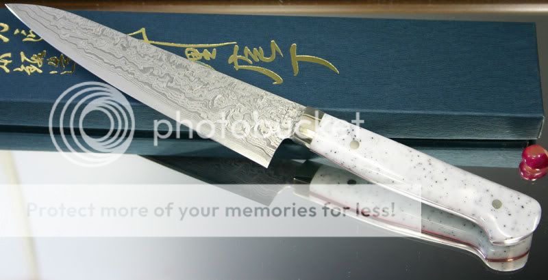

The kitchen knives I have tried this on are a cross section of steels but all flat ground .... it was as true for my cheap stainless peeling/salad knives ... probably 420J... as it was for my best Chef's knife ... an R2 Hiro Itou Sanktou....
Using it on a chopping board the 15 degree edge was a great balance of extreme cutting and edge retention.....15 degrees each side is not "thick" ..... it is "thin" and as thin as Spyderco recommend going on all of their knives which use a number of top steels ....
