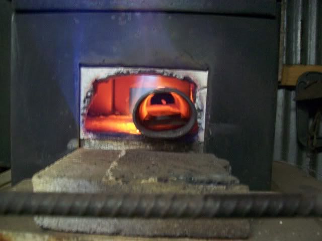

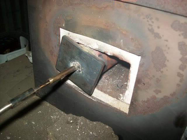

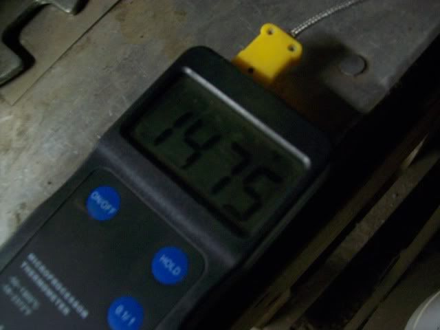

We dont have a RC tester so we try and make sure the heat treat is spot on..We heat treat all our knives in a muffle, in a gas forge. Temperature is controlled manually with a pyrometer..I was supprised but it will hold within 1*-2* degrees for as long as you want..Soaking 1095 @ 1475* for 5-7 minutes is no problem at all.We also now use commercial fst quench oil.
I will try a file just for peace of mind but its a brand new nicholson thats used only for that purpose..
Axes and hawks are heat treated more old school.Then again heat treating a axe and a knife are totally different things....The thing is we have made some many dang axes that heat treating one is like taking a breath..Its just second nature..
Just in case heres our set up..The pyrometer and probe were about $40 I think...Then the muffle is homemade..Not as nice as a $1200 oven but its controlled, even temp...Thats what matters..
