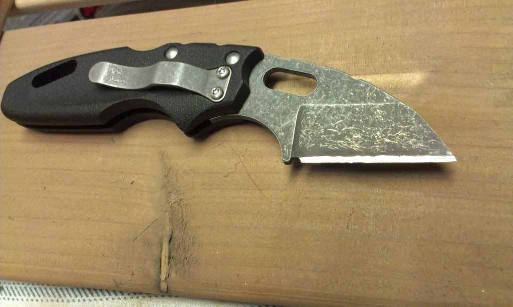

Hey guys my absolute favorite new knife is a Cold Steel mini tuff lite. The thing is an absolute laser cutter. The edge was 28° inclusive from the factory and very thin behind the edge. I brought it down to 24° and mirror polished the edge, then acid etched the blade, lock bar and clip.
I need to stone wash it now, but I hate how doing so destroys the edge.
Has anyone come up with a way to protect it? I've tried tape to no avail and if nothing else I may try nail polish, but I doubt it will survive.

No, that is just nail polish from the acid bath. :) I always protect the pivot area and edge with polish as a resist.
Not sure how I can keep the plastic sleeve on the edge. One problem with the knife is that the tip is barely covered by the handle when closed so if it chipped that would pose a big problem.
The sleeve worked!
Mostly... I'd like to refine the idea for next time and the tiny wharncliffe lends itself to the method greatly (so it may not work as well on another profile) but it hung on in the jar with aggressive shaking for around 3-5 minutes. After that it fell off, but my edge took minimal damage. I'm pretty sure I can get away with stropping.

Getting it ready, I used my sog mt to strip and cut open the wire. Then put elmers wood glue on the edge and slipped the sleeve on.
Hanging in there!
And the finale. Normally I go for a longer "wash", but for obvious reasons I called this good enough. It didn't get down by the edge well, but that's to be expected. I'm happy with the results.

Normally I let it roll for about 30 minutes. It gives it a finer pattern, but the coloring is right and I doubt it would have gotten much closer to the edge.
I use this knife primarily for wood carving. In the bad light of my garage I couldn't tell, but under good light and with my loupe I can clearly see micro chipping. I can easily take care of it though.
Overall I'm pleased with the results and would do it the same way again.
