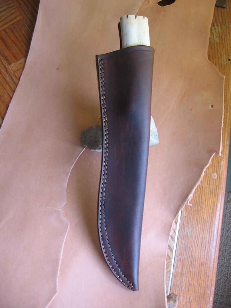

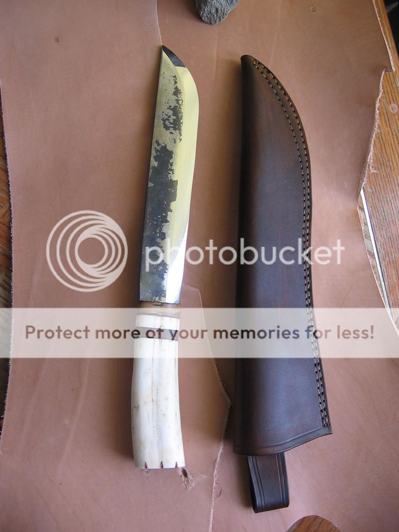

I great friend and customer ordered this big leuku as a user for big game processing (and clear cutting forests):D
He's a huge guy, 6' 8" with matching hands which worked well with such a weighty long blade.
The handle is quite long which balanced the blade perfectly, the feel is fast.

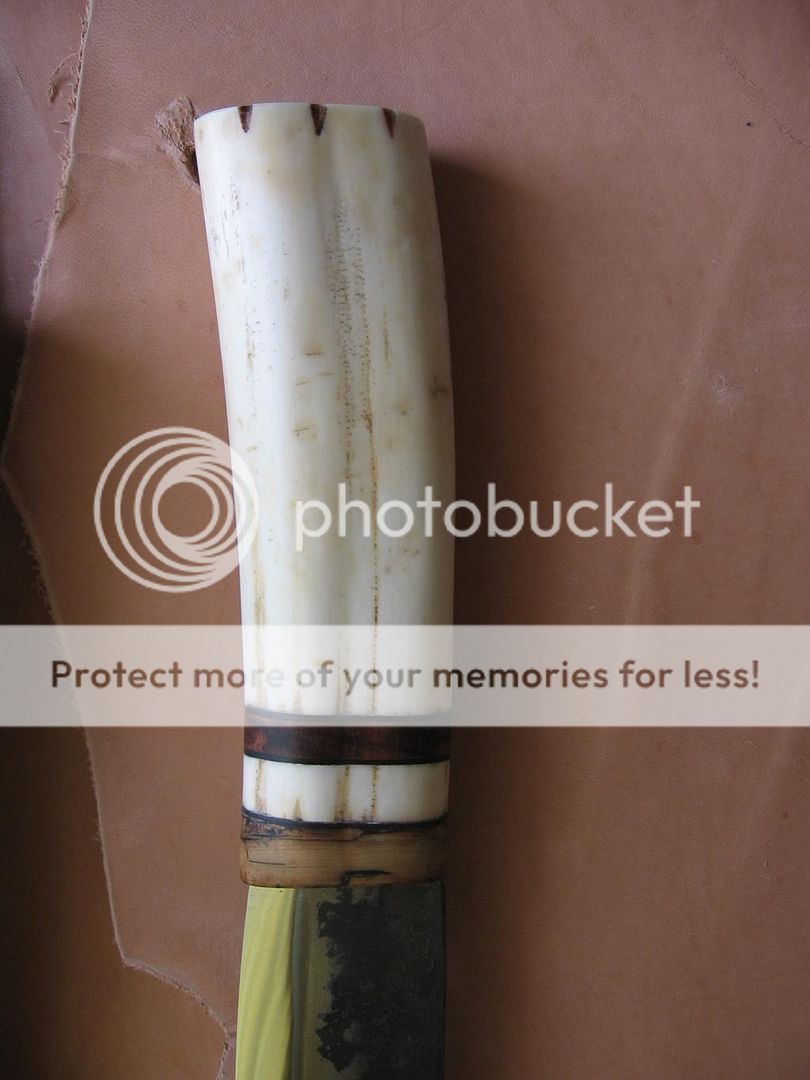

I have to say, the blade is amazing, sharp beyond belief, interesting profile but a serious pain in the butt to fit to the handle.
The tang needed a couple of hours work to make a perfect fit with the Mammoth ivory at the front.
I was going to make him a traditional leuku sheath but he doesn't like the dangler style so we went with a basic tank of a pouch sheath.

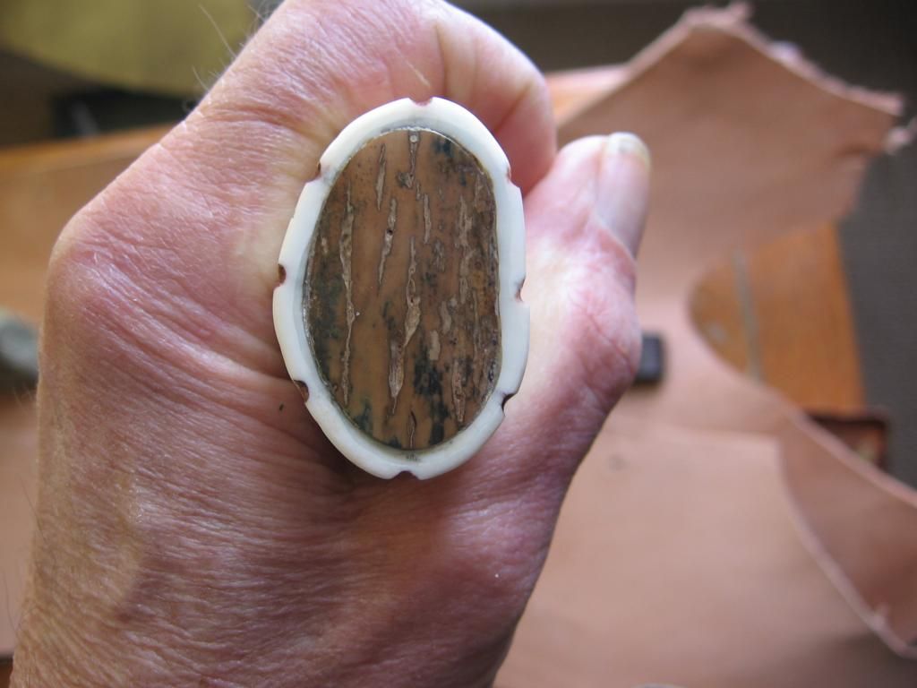

The handle is Walrus ivory which has a wonderful feel in the hand and some neat animal chews that my friend wanted to keep. This meant hand shaping the handle pieces to the contours of the tusk :o Anyway,it's finally in the hand of it's happy owner and to be honest, i'm happy to see the end of the project :D
From front to back of the handle, Mammoth, fiber spacer, a section of the Walrus,spacer, a piece of curly Birch, Walrus with the butt inlayed with Mammoth.
Best regards
Robin

The blade is 9 1/4 tip to tang and the handle is about 5 1/4 inches.
